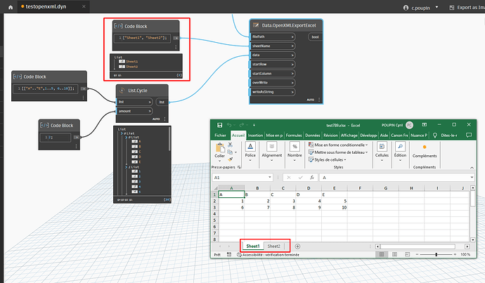

you can use directly the OOTB node Data.OpenXMLExportExcel, it works with multiple sheets / datas at input
Thanks! Didn’t know it could do multiworksheet for one file path, nice one.

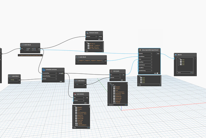

Will you be able to provide the screenshot of the whole script please?
When I tried with OOTB, it shows me error on data.openXMLExportExcel node
