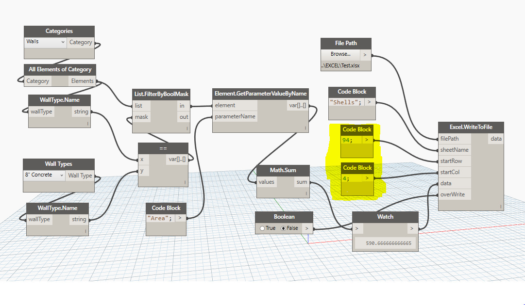

New to Dynamo… FYI. I’ve attached a screenshot of my functioning code, but the problem is when I add a new row into Excel, the Code Block referencing the Excel grid does not track the change and automatically update.
My excel file is a live document that will be changing constantly and, if possible, this functionality would save me hours of time. So the question is, can Dynamo track the changes caused by additions of rows & columns and automatically update the Code Block in the attached string?

Thanks for taking a look at this. I’m actually trying to go the other way from Excel to Dynamo. When I add a new row into the excel file, I have to manually go back into the Code Block and update the Row number. See attached.
Is there a solution for this?

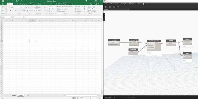

For Dynamo to detect changes in Excel you’ll need to restructure your graph to include Excel.ReadFromFile in your workflow.
Here is the solution using “MATCH” function in excel which specify item in a range of cell, and then returns the relative position of that item by column and row.
That’s it Kulkul!!! Thank you!!!
