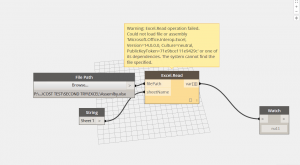

The new Dynamo 7 Excel Read Node is giving me an error as follows:
Warning: Excel.Read operation failed.
Could not load file or assembly ‘Microsoft.Office.Interop.Excel, Version=14.0.0.0, Culture=neutral, PublicKeyToken=71e9bce111e9429c’ or one of its dependencies. The system cannot find the file specified.
I have heard that Dynamo 7 doesn’t like Office 2007 Files? Is this accurate? If so, anysuggestions besides buying Office 2013 would be much appreciated.

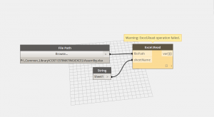

(this is the most recent screenshot from dynamo 7.1 trying to link 2007 file)
