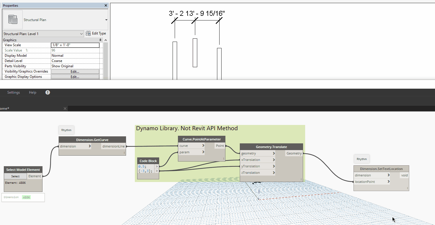

How so? Dynamo nodes support a “kit of parts” style of thinking. Example: Rather than me (john) make an addin to “fix” a user’s dimensions strings, I simply give you the pieces to do it yourself in node form. (Ex. Below)
Tell me how the heck I am supposed to know that this is what the end-user wanted to accomplish as the end result had I built it as a single button add-in? Also, this specific example uses methods available in Dynamo (not the RevitAPI), combined with RevitAPI methods. The comment about “Creating Revit add-ins being faster” seems to have very little basis.
Loseley Using your example as I don’t understand how Rythm or you code works on the dims in this case - If I wanted to have those dims stack on top of one another- how do we do that?(We stack, we don’t alternate) I cannot look in the rhythm package and extract the PY or C# nodes because it is bound. There may be a way to alter the dimensions, but that is a dead end and I have to look elsewhere because of a bound node.
But - if that ingram, that tiny piece of code is fundamental atom of existence to Dynamo and Revit where the functionality is perfect and does everything revit allows for that object- why is it external to Dynamo and not incorporated into Dynamo base package for distribution?(Konrad apparently incorporates into the primary package- what about others?) Are the Revit Dynamo owners bogarting the code?
The Rhythm compiled DLL node is faster to execute while in that node- but has portability issues for medium or larger distribution groups- or looking back to old vs new versions. Potential security issues, etc. I am not going to the extent of reverse engineering through a decompiler to look at code - nor sould anyone have to.
