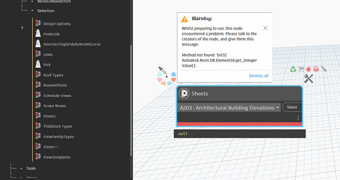

FYI @john_pierson - looks like the version of Rhythm I installed yesterday has a 32 bit element ID issue.
@EzDoesIt you’ll have to wait for a fix from John to get this version working again, but you should see it in the library as per my screenshot.

I really do suggest to use the OOTB variant, but this is patched in the latest release if you reinstall Rhythm through the Package manager. I did mark the node as deprecated so it is not findable in the library anymore, but an upgraded graph should resolve with the node.
Note: you need to restart Dynamo after installation for the UI nodes to resolve.
