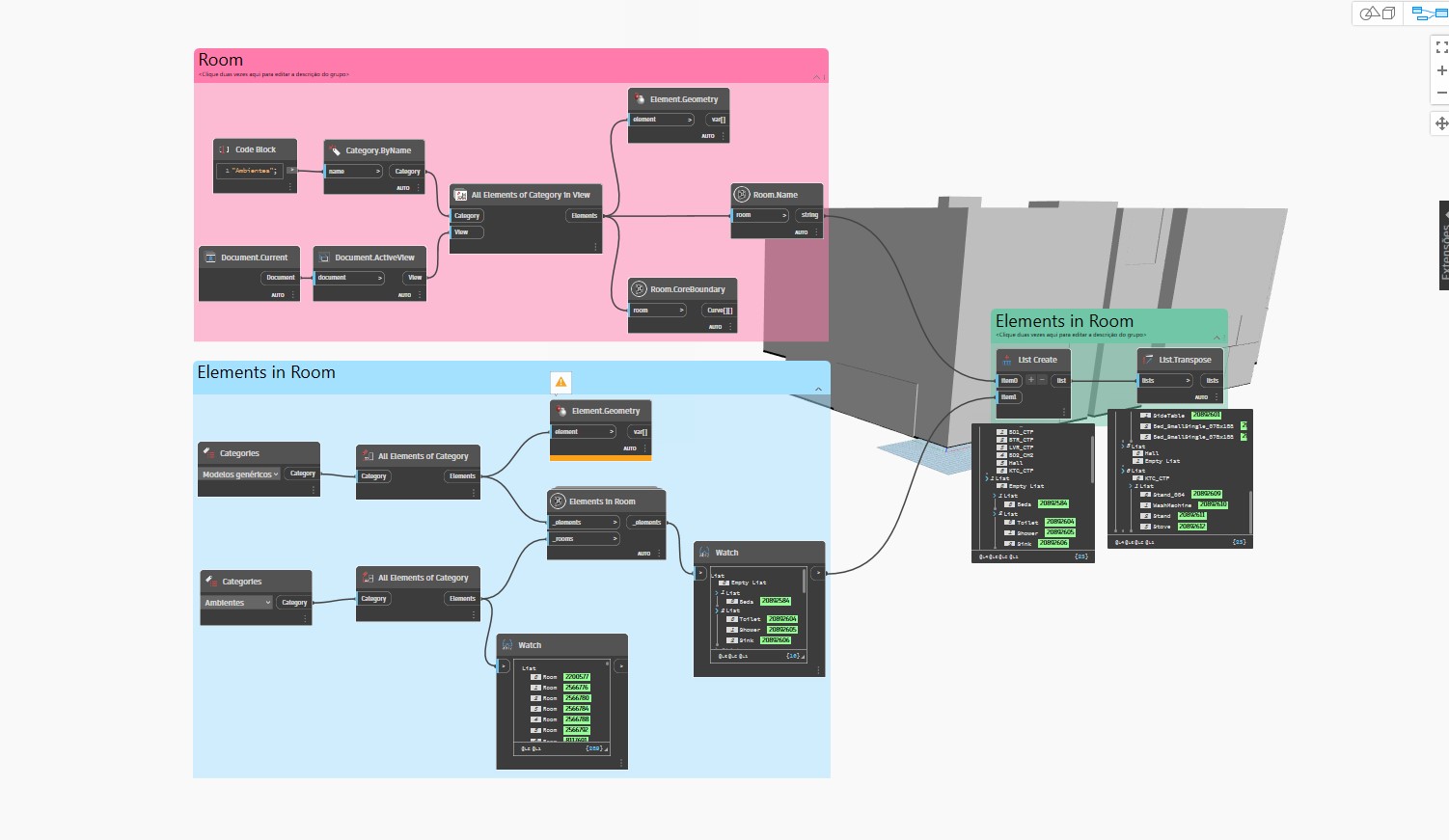

Could anyone help me with the routine below?
I am trying to combine the data of the environments, with their respective names, and the names of the families of generic models (furniture) of the project.
Then I needed to separate and identify which families are within each environment. In other words, separate each room and the furniture in it.
How can I do this? Do I have to use boundaries? Create curves demarcating each room? I tried a few things but I couldn’t, how could I do it?

Perfect! Thank you very much. Here’s a solution for anyone who needs it.
