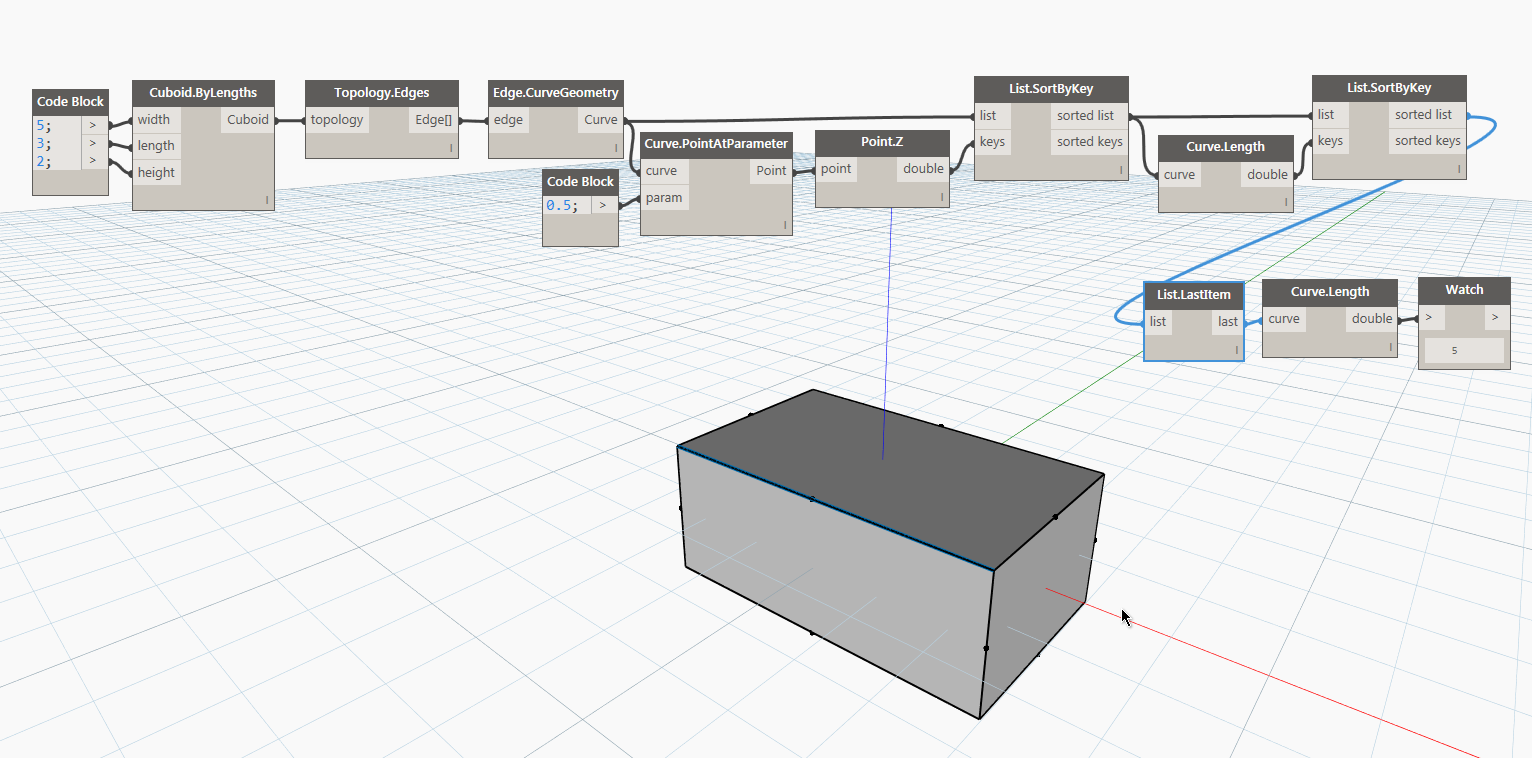

Similar to what Mike suggested, you could try sorting by a few properties:
That looks promising. In my late night research I found surface.FilterByOrientation from clockwork and that simplifies this a bit. To give a bit more context to my problem, I was trying to look at side lengths of strip footings under walls less the pad footings. Revit so kindly gives the gross footing lengths instead of the net like it does for volume. Any further ideas are welcome.
