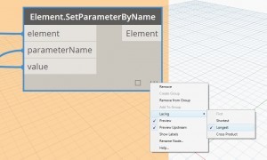

Change the lacing of the last node to Longest
20150721-1
Now i feel stupid ahahah
Thanks for the heads up
Ok, at least i feel much better. This allows me to enter a value in ALL sheets but it enters the same values.
So i’m still not get the individual values assign to each sheets
