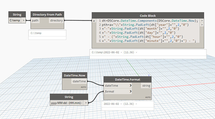

Even though this topic is quite old I’d like to ask something:
Why didn’t you guys use the DateTime.Format node?
Seems less cumbersome to write and maintain and gives the same results:
Also, something weird happened to the code @Garbage_Collector posted, so I had to manually change some things, here is the code which doesn’t need editing:
dt=DSCore.DateTime.Components(DSCore.DateTime.Now);
pth=a+"\\"+String.PadLeft(dt["year"]+"",2,"0")
+"-"+String.PadLeft(dt["month"]+"",2,"0")
+"-"+String.PadLeft(dt["day"]+"",2,"0")
+" - ("+String.PadLeft(dt["hour"]+"",2,"0")
+"."+String.PadLeft(dt["minute"]+"",2,"0")+") - ";
