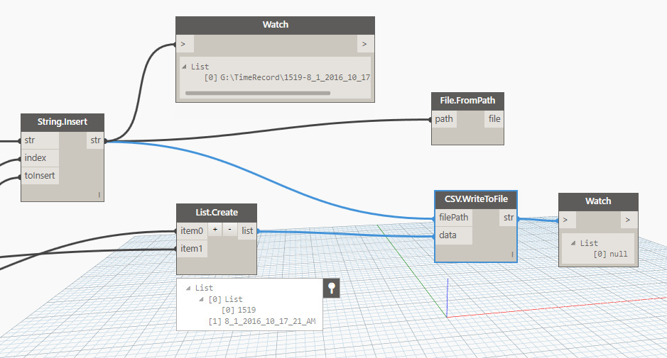

I’d like to see across the office what files are being used when.
I think Dynamo maybe able to help me. My approach is to create a New CSV file named:
[Project Number][FileName][TimeStamp]
I am able to create a file with
However this is only creating a file each time Dynamo is re opened not each function.
I think it is because, DateTime.Now stamp only updates when dynamo is opened up.
Does anyone have any suggestions on Date.Now or any other way to achieve my objective.
