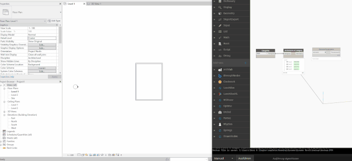

@Schasfoortyoeri were you working in a perspective view?
I noticed that if you switch from a generic view to a perspective one, Dynamo shows this error.
If you switch to Automatic it works again, and even if you go back to Manual mode it works, at least until you don’t change view again and come back to perspective.
Sounds like a bug, isn’t it?
Here a screencast, sorry for the German (although Revit is in English, it conflicts with German OS) but the red message is the same as reported in the topic:
