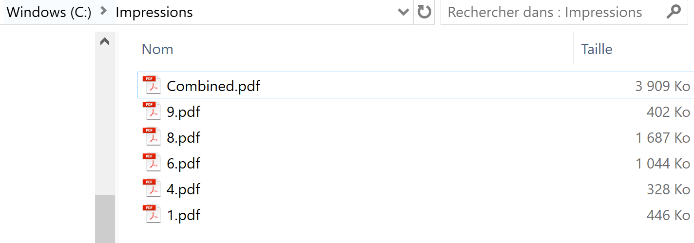

I added to the package “GeniusLoci” a node to merge pdf.
You can use it at the end of the print like in the picture :

So, the printing of sheets works now !
I advise you to connect the sorted list of the SortByKey node to the input Views of the Print PDF node, to always have your lists in the same order.
