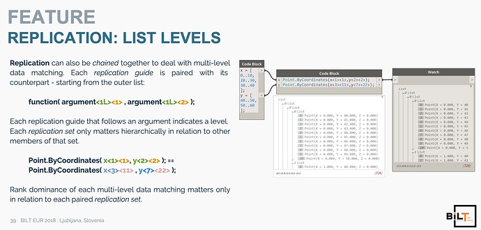

@Alien if you want to dive a little deeper, you can take a look at my DesignScript guide from BILT Ljubljana :slight_smile:
Specifically, pages 37 through 44, some snippets shown below.

However in doing so you’d lose the flexibility that replications guides allow. Just like Python can do some list handling which nodes can’t by implicitly defining the loops, replication guides can say 'make the Z points first, then the X, then they Y but use the XY with longest lacing and the Z with cross product… But the with the Point.ByCoordiantes node (or any node for that matter) will only allow starting with the X value (or whatever the first input is for other nodes). This is a known limitation of nodes (and in my opinion a primary limitation in visual programming today), with no functional resolution (list levels can get close, but you can’t entirely replicate this).
As such, this theoretical universe where you’re made happy by adding lacing and list levels to inputs of code blocks suddenly removes a feature of the application which others enjoy (i.e. many of the amazing works of @Vikram_Subbaiah which just cannot be recreate in nodes alone). This means that the theoretical universe is not likely to come true, as much as I would like to see every forum user get every feature they may want.
