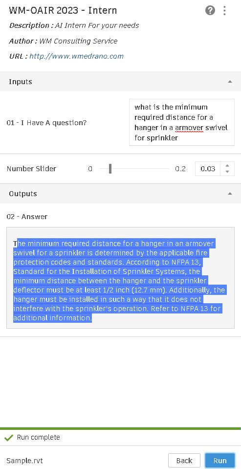

Here is my first proof of concept. All my millions are stuck in Silicon Valley Bank, so anyone willing to Invest in full development send me your bit coins.
of course, this will be the Basic way we would all use ChatGPT with dynamo player. Please feel Free to Deploy in your workstations.
  1. The graph will log the answers and response by date and user
  2. Once fully deployed for Engineering firms to test, I would like to collect all the answers and questions from your company to create a data base of engineering/Architectural/Building Practical uses of AI responses and Cycle them back to be analyze by a smarter version of the ITERN in later updates.
  3. Future collection of data will help developed other graphs with Specific sector focus, such as electrical, fire protection structural, fabrication ect.
  4. This could be a great teaching tool and also a powerfull augmenter to short handed design teams and international design collaboration.

The responses are still “Sub-Primal” but the GPT3 model is much better. Thanks again for the update and i can’t wait to see what other ideas this Package will spark on the community.
if anyone is also interested im adding the Text to speech output also on the graph.
Now we can have Ai Q & A logged and the computer also read the response.
I asked Chat GPT 3.5? 4 now to write this python with the help of the forum.
