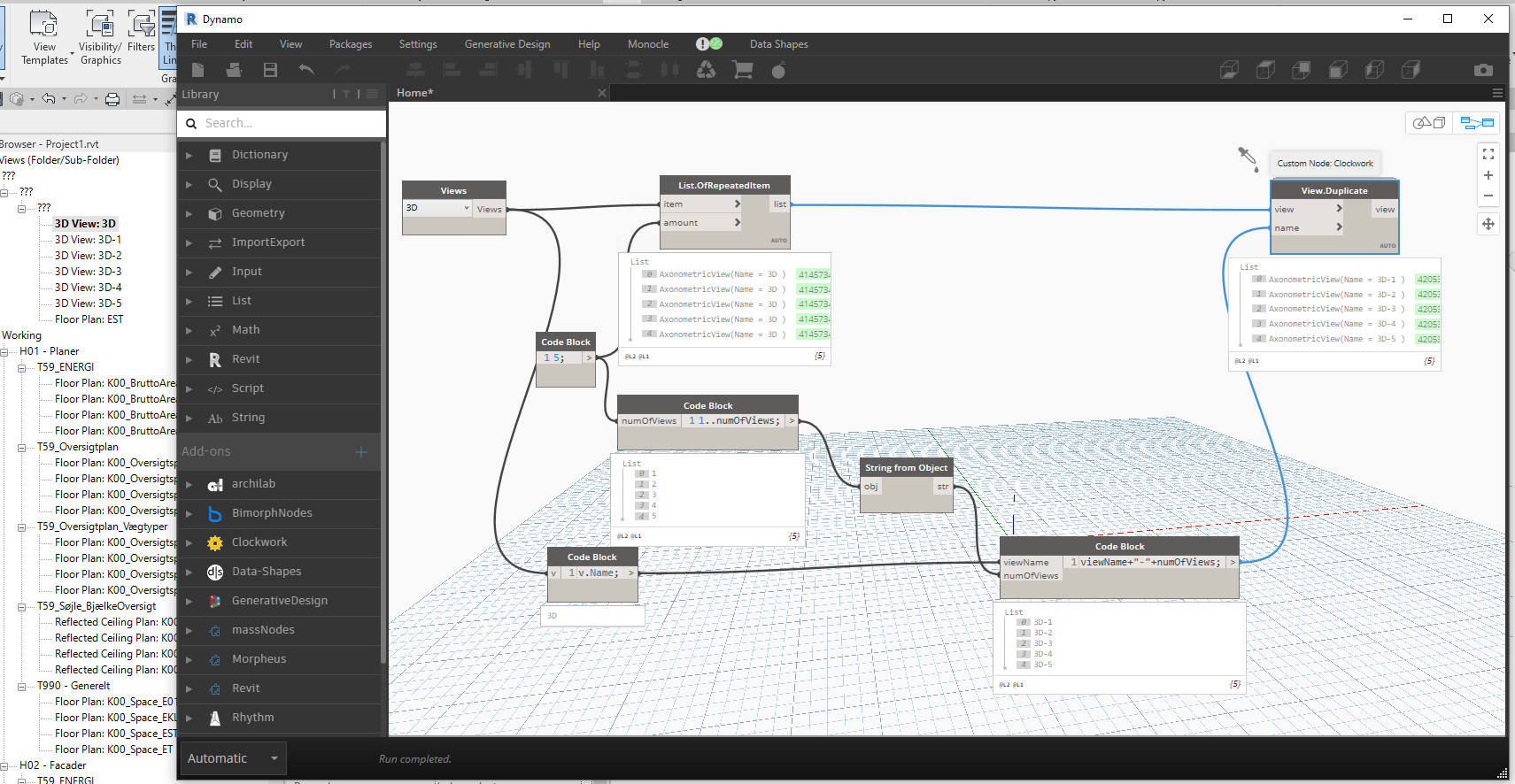

I want to copy a 3D view 7 times and put the same view template. But i can’t find a way to find my 3D view template.
So far i got this.

There’s probably loads of ways to do this depending on where you are starting, but here is an example:
Edit: Ah yes… 3D view templates are still not accessible via the API :-S. Common ADSK! But hey, if you apply your view template to the 3D-view before you duplicate it, all the duplicates should have it applied as well ![]()

Here’s my original answer with the setting of the VT incorporated:
#Import the Revit API
clr.AddReference('RevitAPI')
import Autodesk
#Import DocumentManager and TransactionManager
import RevitServices
#Reference the active Document and application
#---###Start scripting here:###---#
views = UnwrapElement(IN[0])
vt_Name = IN[1]
fec = FilteredElementCollector(doc).OfClass(View).ToElements()
vt = None
for i in fec:
if i.IsTemplate and i.Name == vt_Name:
vt=i
#Transaction start:
for i in views:
i.ViewTemplateId = vt.Id
#Transaction end:
OUT = views
