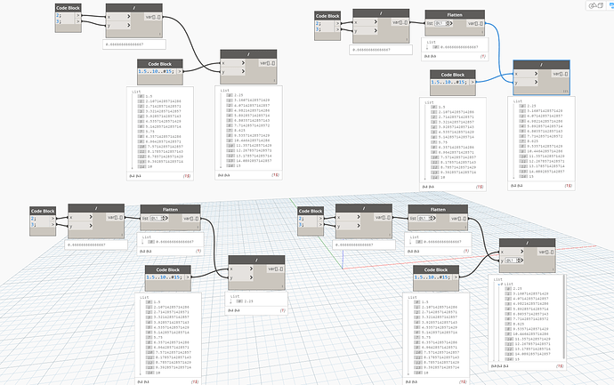

I am attempting to divide a list of digits by a single digit out from a division (math) node, but the resultant list is only has a length of 1. It’s only performing the operation on the first item in the list. If I replace the divisor (single digit) by a constant from a code block, it works as excepted. Something about using the number from the division node is causing it to behave oddly. Any suggestions?
Change the lacing of the division node to “Longest”, or to “cross product”. You can do this clicking with the right button on the node.

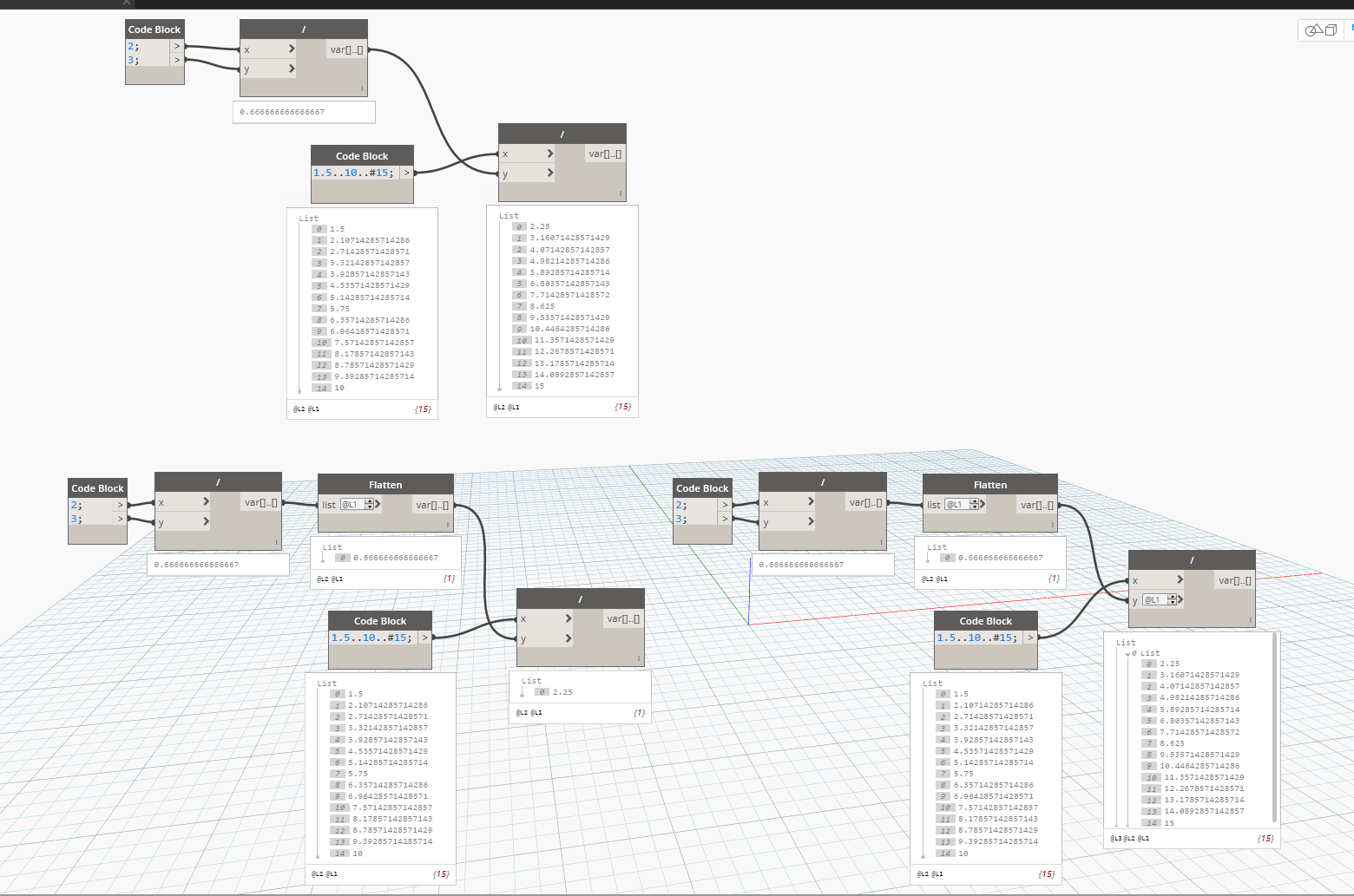

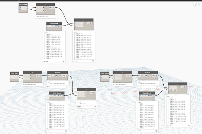

use flatten node or set up the levels
see picture
see following link for explanation of the use of listlevels
http://dynamobim.org/introducing-listlevel-working-with-lists-made-easier/

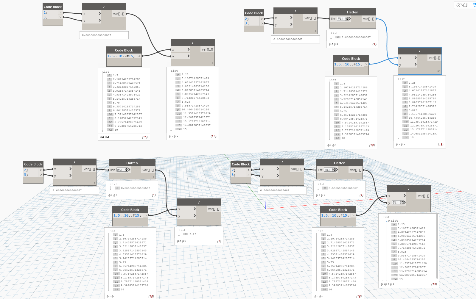

and here is the link for tiagocorradi solution:
http://dynamoprimer.com/en/06_Designing-with-Lists/6-1_whats-a-list.html
see also mine seccond picture i added tiagocorradi his solution:
Thanks! I got it to work by using level 1. I’m not sure how you are getting it to work in your upper most example without flatten and without using levels.
