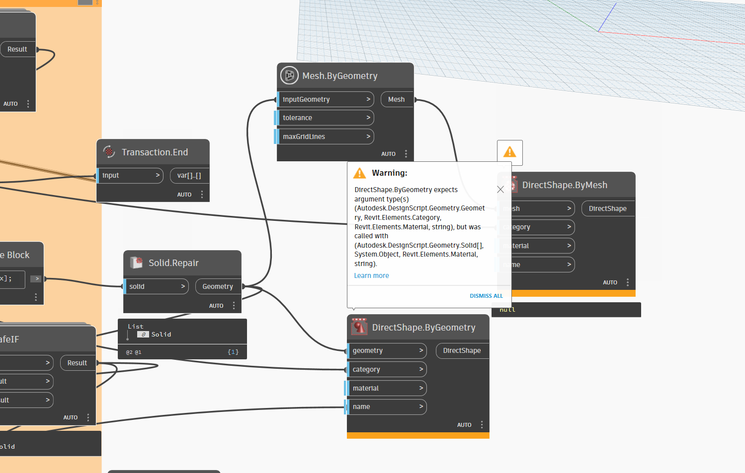

As far as I know solid is geometry and mesh is mesh but I dont know how to handle these errors. Please advise:
You aren’t providing a category but a system object for either version.

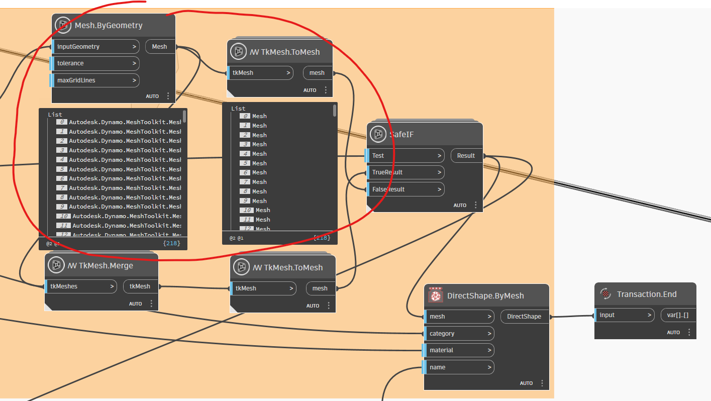

A MeshToolkit.Mesh isn’t a geometry in the second screenshot.

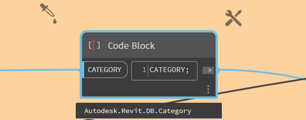

for the second image. doesnt the directshape by mesh require a mesh? how else can i feed it what it needs? I am feeding both a category element. what exactly does it expect? this is what I am feeding it:

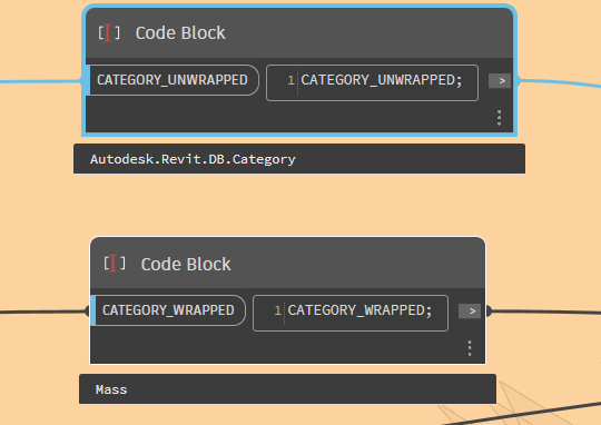

For the category: This is an unwrapped Revit category. You need the Dynamo wrapped Revit Category.
Try looking at the result from a category drop-down as an example for what you need.
For the mesh: A mesh toolkit mesh is not the same as a Dynamo mesh. As such you have to convert it.
THIS WORKED @jacob.small THANK YOU
