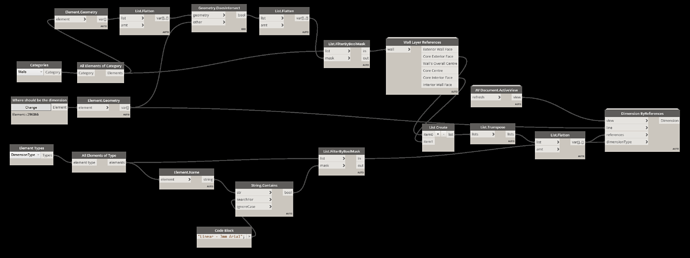

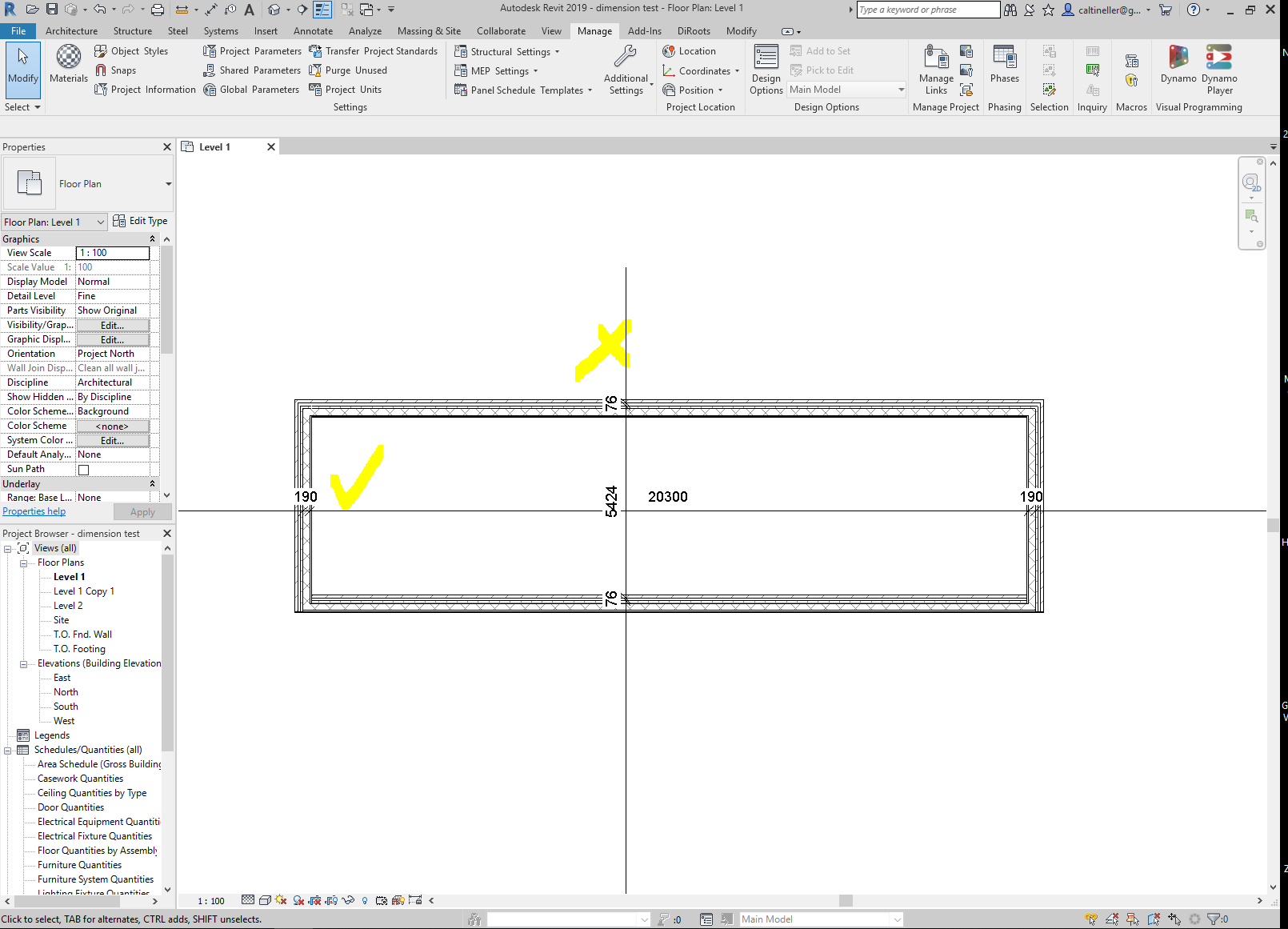

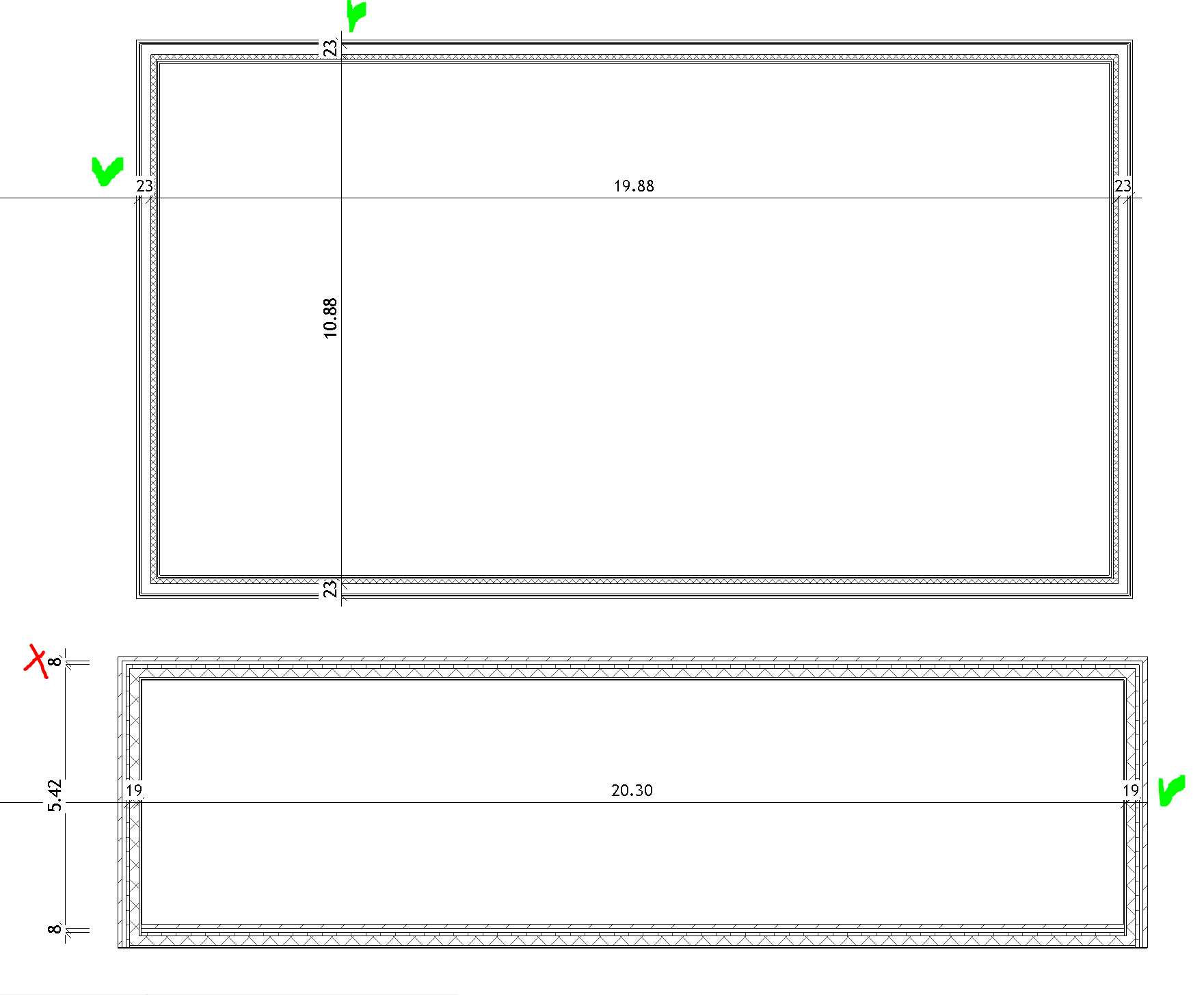

I was trying to intersect a line and walls that are touching it, then dimension these walls from core to core. Horizontally it works perfect but vertically it references somehow wrong places. Any ideas? My dynamo workflow, the Revit file (2019) and the screenshot of error is in the attachments.
Thanks in advance
dimension test.rvt (1.3 MB) Dimensioning from Core to Core.dyn (50.8 KB)
