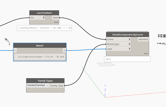

@jacob.small please explain. Levels, from my understanding, would not give me the option to specify which view the detail component would be placed in.
I think @jacob.small means @List Levels read this http://dynamobim.org/introducing-listlevel-working-with-lists-made-easier/ . Have you tried right clicking node and change lacing to longest?
Thanks!! I dont know why i didnt think of that… it worked.

Didn’t resolve it for me. I can’t even place a single instance.
I also tried modifying the code. (I can copy and past script, but that’s the extent of my python skills. I’ve also written some VB.NET in Grasshopper…but that was five years ago.)
I’ve lost at least 45 Minutes to this and an VERY FRUSTRATED.
Revit 2021.1.4
Dynamo Core 2.6.1.8789
Dynamo Revit 2.6.1.8850
Clockwork 2.3.0

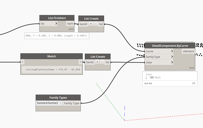

Use List.Create after FirstItem and CeilingPlan…
Sorry. I think I figured it out.
I have some sloped columns and some straight columns.
The straight columns were returning a null value which i filtered, but I think I was filtering the wrong list.
Just as an FYI, it was the view.plane → curve.pullontoplate which got me there:)
Maybe I just needed a break. Thank you for the responses!!! Sorry.
