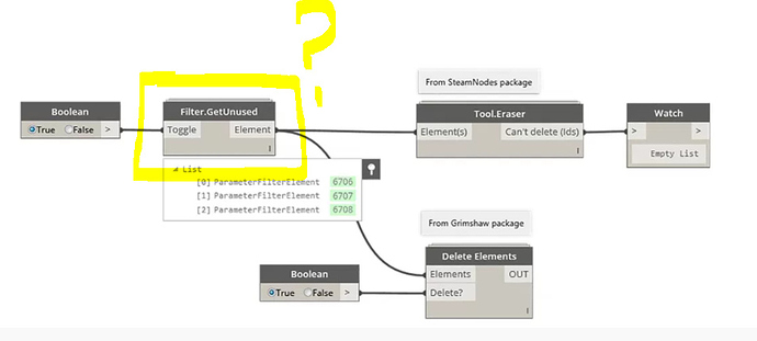

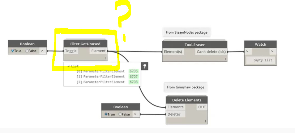

I am looking to replicate a routine by parametric monkey that deletes unused filters. As you all know purging revit filters is anoying since there’s no clue on if the filter is being used or not (different from view templates for example).
Below the desired routine
Highlighted in yellow a node from BVN I cannot find. I’ve tryed downloading BVN, I’ve also tryed following [Filter.getUnused & delete Elements Node MIssed](http://this post) but I cannot seem to find the node. Any clues?

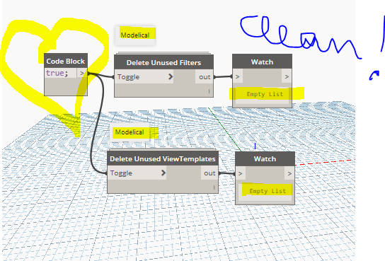

The package Modelical appears to have a node that does just what you are seeking to do :slight_smile: image
Hi @awilliams. Thanks for the tip. It worked perfectly
Deleting unused view templates is a cool node too from the same package.

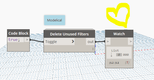

I have just come across this node and it looks great. Only issue is it doesn’t work for me. It keeps saying “null”
Currently using Revit 2016 with Dynamo 1.3.2 and Modelical 1.3.8
Any ideas why it wont pick up the filters.
The delete unused view templates works great though.
@Andrew_Harp I can’t say for certain without some more information - possibly you do not have unused filters? The course of action I would take to troubleshoot this would be to hit edit custom node and copy the internal contents of the node (it is likely a python script) and paste it into your graph in place of the node. This way when you run the graph it will be easier to what the error is!

I was playing with this toady and realised that you need to have at least one filter applied to a view for it to work.
I was previously testing in a black template with no filters applied to a view, which was causing the null.
