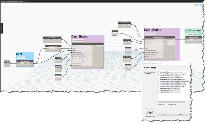

Deleting Unused Filter Using Dynamo with DataShape UI
In Revit there is an instance you want to get rid the unused filter.
Using Revit Purge Unused and Ideate Explorer were unable to select and delete them.
Manually deleting them on VG does not tell you if it is unused or not.
In this Script:
Get the unused filter > Feed to Data Shapes UI > UI Data Shapes pop up > Select Filter > Delete
Custom Nodes:
BVN
Data-Shapes
archi-lab. net
