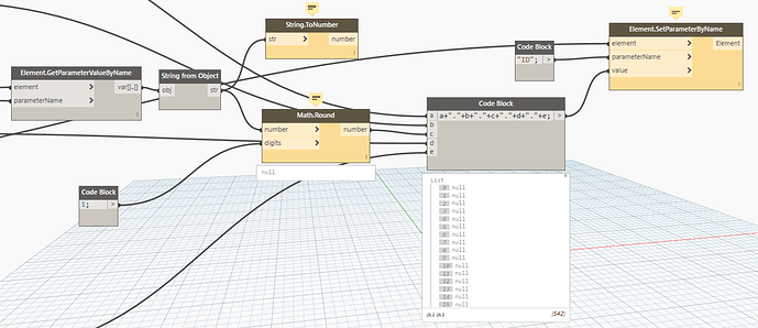

Hi all, when I get the value of the length parameter, I get a number with 4 decimals. I tried with several methods, but when returning the value to revit, the decimals reappear. How can I solve it?

@Jordivdl What is the parameter storage type for “ID”. Make sure it is String.

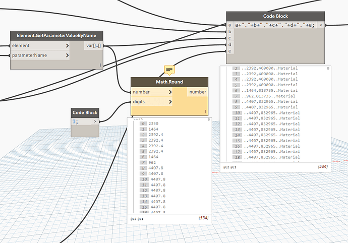

The idea is to assign to a structural column or beam several parameters (name, type, length …) to concatenate them and return them to revit in another parameter, called ID. But the length parameter, I do not need decimals, as I return it in a text parameter (ID), write all the decimals.

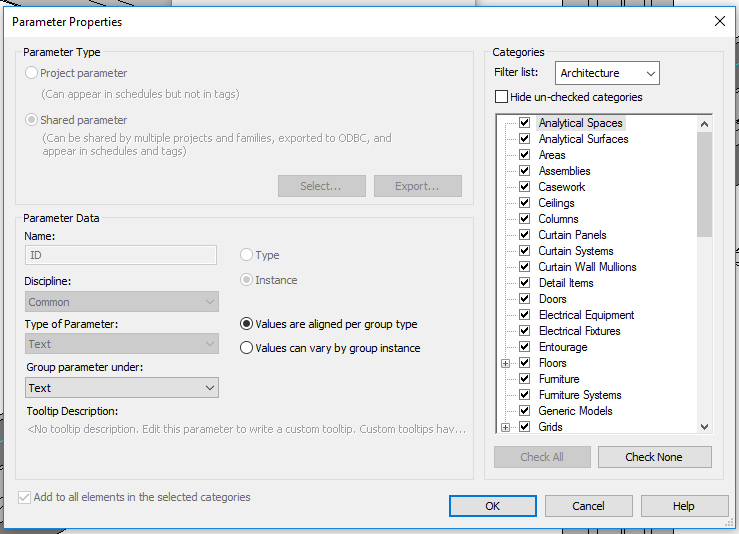

@Jordivdl No problem. Can you show us screenshot of your “ID” parameter properties.

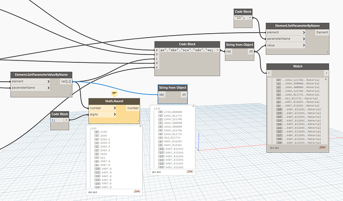

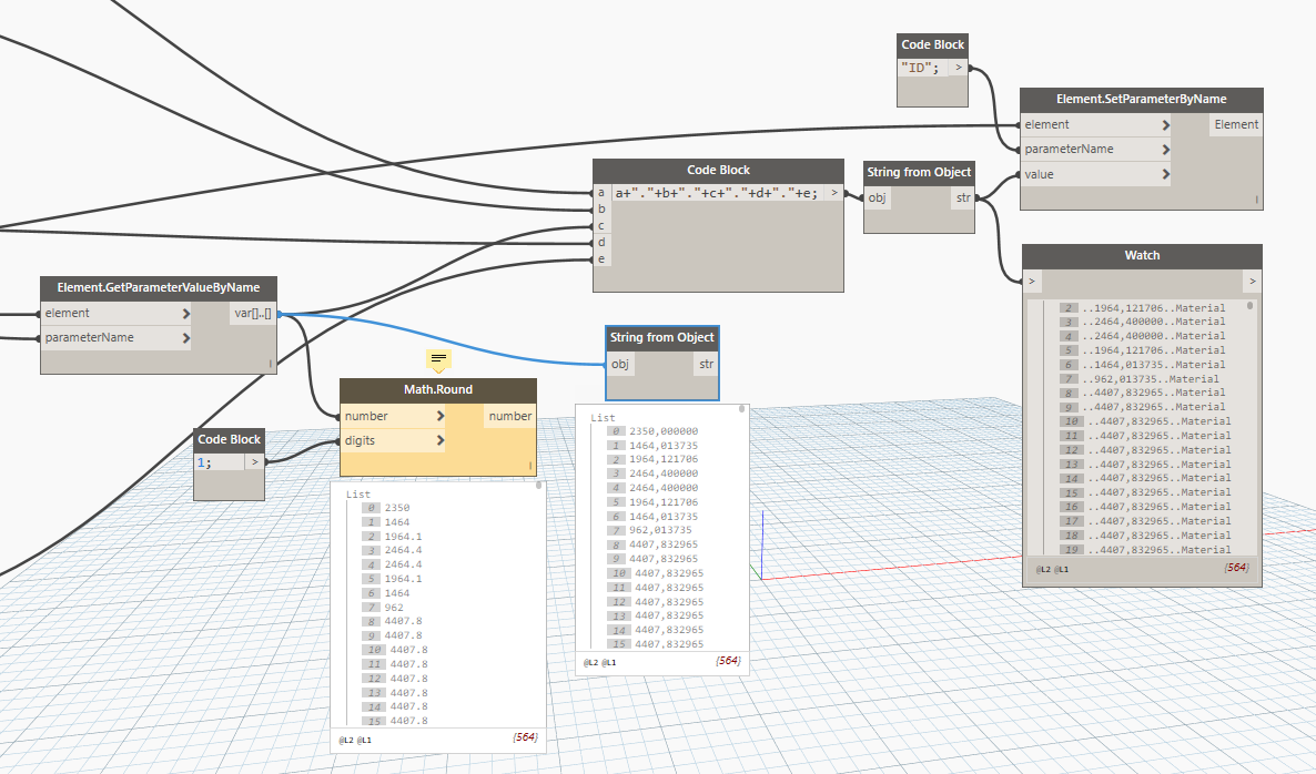

@Jordivdl Add “StringFromObject” node and connect the values to SetParameter node. See if it helps
@Jordivdl Now how does in revit looks like?
@Jordivdl It works for me. Looks like it is a bug or may be language issue. Try reporting here
