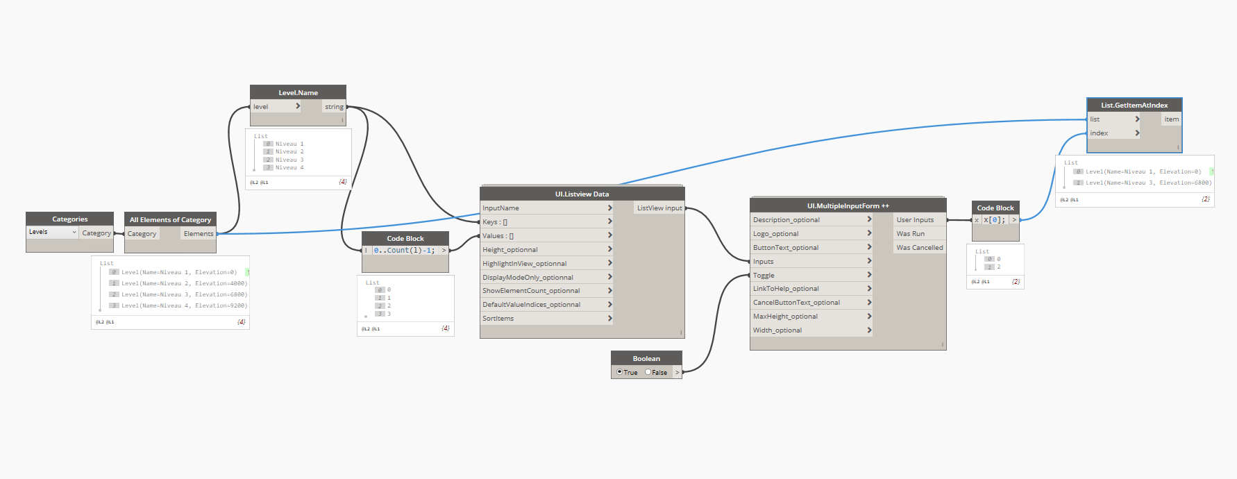

The way it works right now, it will always display the id if the values are revit elements. This is meant to prevent issues when several elements have the same name. I might do something about it in the future but for now what you could do is feed the list view node the element names as keys and indexes as values, then use the indexes from the output to retrieve the items in your initial revit elements list .

I was describing something like this :
then using the index to retrieve your elements :

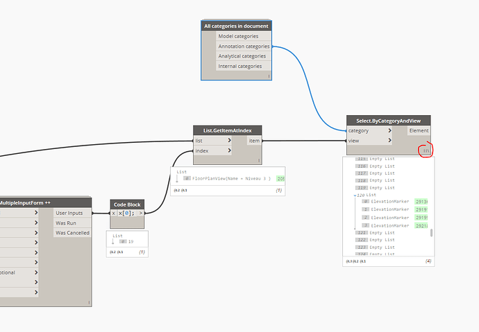

Switching Select by category and view’s lacing to longest should get you where you want :
you’ll get empty lists for all the anotation categories that are not in the view though…
