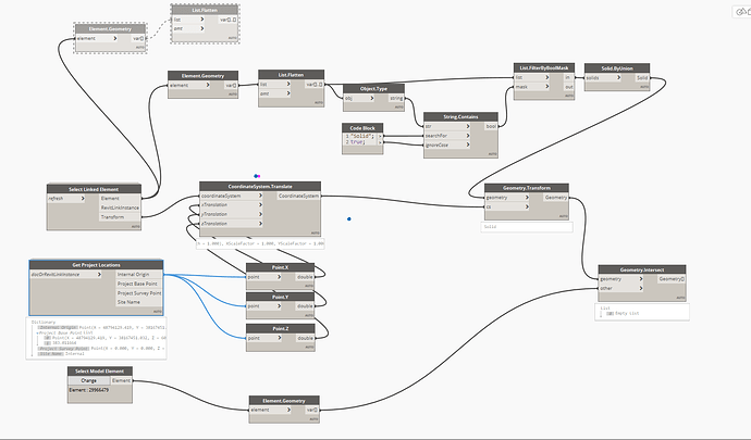

I try this script but still getting empty list at Geometry intersect please can check my script
Try sending a screenshot of the Revit element and the link element in the 3D view which part of the intersection
here is another way, know its for airterminal and rooms, the principle should be almost the same
