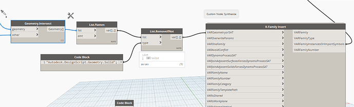

Cut intersect elements, Dynamo

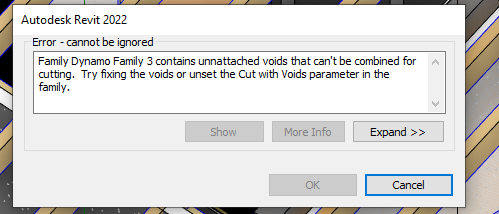

When I did that, this happened. Do you know what might be the problem?

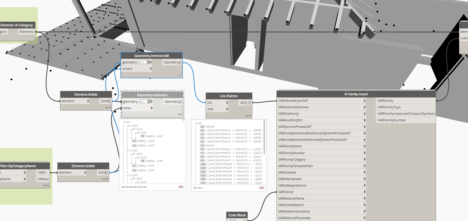

not sure then…do your both have stacked walls and normal walls ? have you tested on 1 wall with multiple rafters ? but you could try filter out so you only have solids…
Thank you very much, The solution was in your earlier message, I apologize for mixing up the order but it’s working now :slight_smile:
