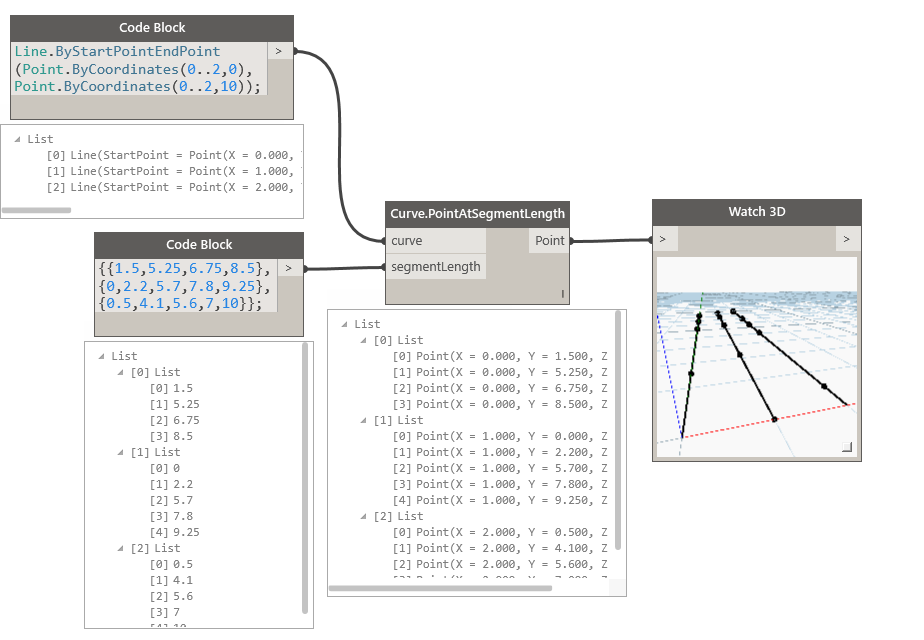

I am trying to array points down a curve. I have a list of of curves and an equally as long list with lists of distances. How can I get Curve.PointAtDistance to use all the distances in the list for each curve rather than just the first one. If I pullout just one curve and one set of distances it works.

Curve.PointAtSegmentLength should work for you
