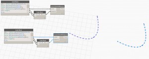

I am new user to Dynamo and have little problem. When i am trying to use Curve lenght as parameter for points on curve, it gives me just one point. But if i use lenght as number it works ok. Could you help?

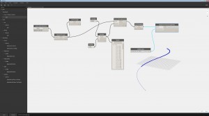

At first I thought it’s because the Curve.Length’s output in your case is a list, however it seems to be working fine for me in either case. Did it work after restarting Dynamo?

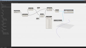

Because both input for PointAtDistance are nested list.(when u use number, it’s not a list) Make single rank list at least one of them. use flatten or getitem…etc.
Or ,you can use List.Map as well.
