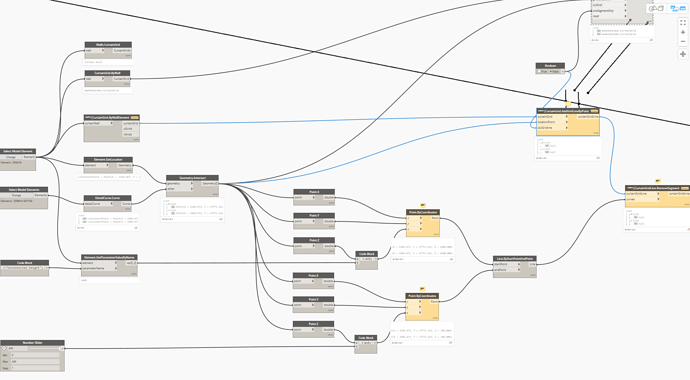

Hi, guys! Perhaps my issue is not too complicated, but I have been struggling with it for a while, so I have decided it might be better to ask.
I am trying to create a script for automatic placement of gridline segments where a door would be placed later on. I tried doing that by creating the complete gridline and then removing segments beyond specified height. The problem is that CurtainGridLine.RemoveSegment from Rhythm package would not work.
I think it could be related to the way I obtain the CurtainGrid from the Wall. I noticed that by using custom nodes for that purpose, I would get for example “WombatDynamo.CurtainGrid” element, or another one, depending on the package used, but none of them seems to work in my case.
I am using a selection of detail lines to determine grids location.
This is how the script looks at the moment:
You can also find it attatched. Here is a link to download the file I am using for testing: https://we.tl/t-6qBjEtKjp6
