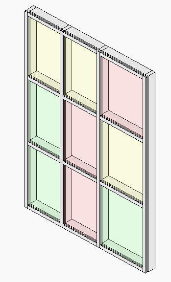

First time shuffle:

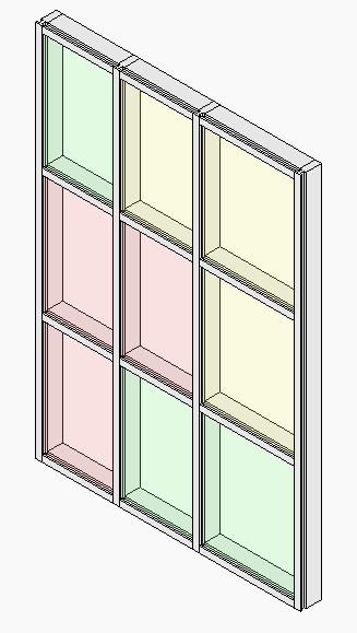

Second time shuffle:
