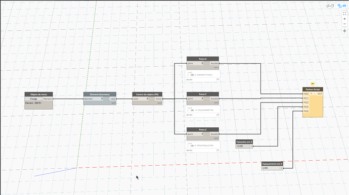

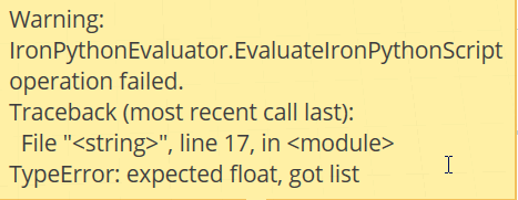

I trying do create this points with Python Script, but when i Run the script get this error mensage:
Rotina de pontos - Error Messange
Python Script

What i wanna do is create lines to be used for a Grid. I want the user to inform the start element, the X and Y size of the Grid and spacing of each point in X and Y. To do this i think about getting the center point os the element and creating points to create line and then creating Grid with this lines.
@rinacimareller
# Enable Python support and load DesignScript library
xi = IN[0][0]
yi = IN[1][0]
zi = IN[2][0]
xf = IN[3]
ex = IN[4]
count = xf/ex
list = [Point.ByCoordinates(xi,yi,zi)]
temp = 0
#Place your code below this line
while count > 0:
	xi += ex
	list.append(Point.ByCoordinates(xi,yi,zi))
	count -= 1
#Assign your output to the OUT variable.
OUT = list
Thanks man. Helped a lot :+1:t3: :+1:t3:
