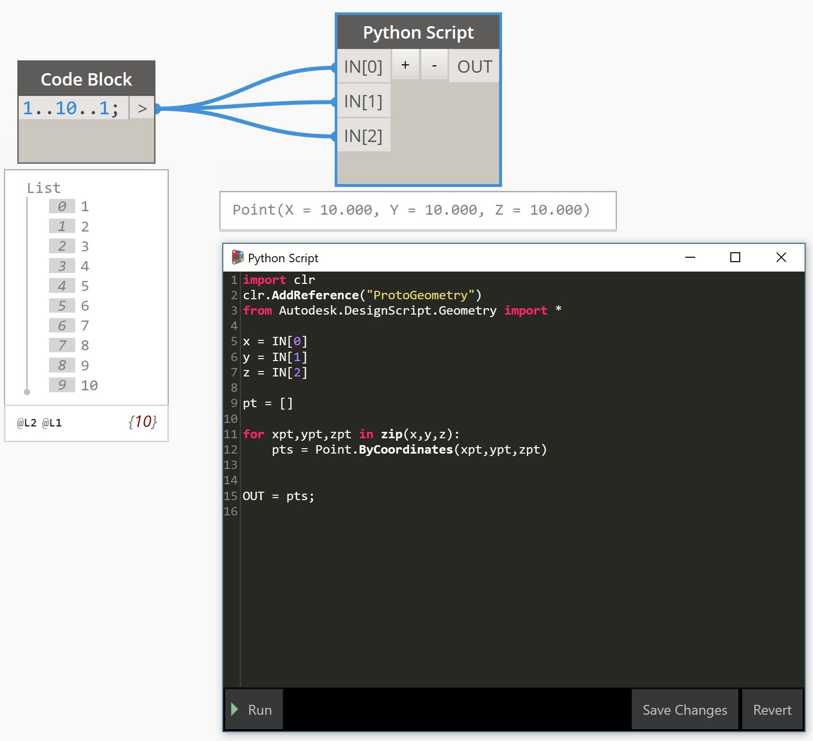

Can someone point me to where I might find a link describing the missing part of my code to create multiple points not just the last in the sequence.
I am happy to read any reference, but would apreciate any help in finding a good link explaining this paticular process.
clr.AddReference("ProtoGeometry")
x = IN[0]
y = IN[1]
z = IN[2]
pt = []
for xpt,ypt,zpt in zip(x,y,z):
	pts = Point.ByCoordinates(xpt,ypt,zpt)
OUT = pts;
Thanks.

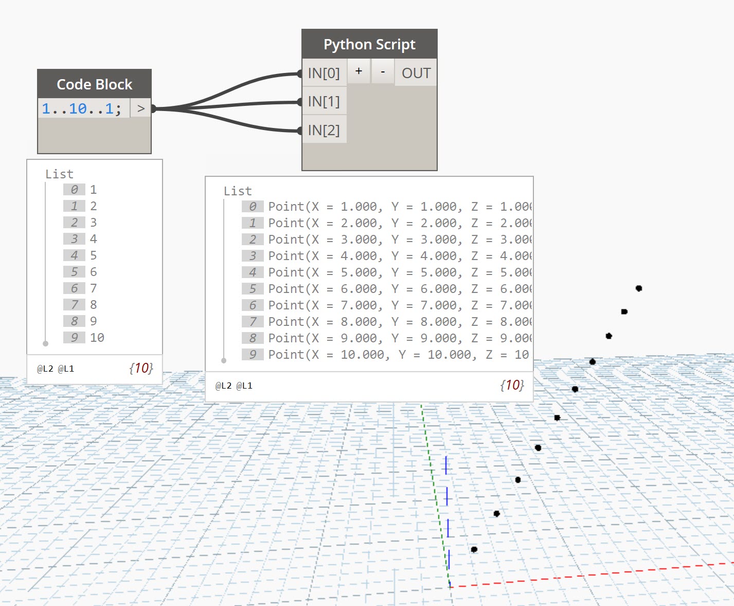

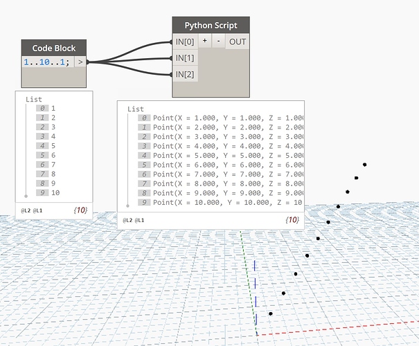

Your output in the code above is the last created variable called “pts”.
Instead you should use your list “pt”, created before the loop:
pt.append(Point.ByCoordinates(xpt,ypt,zpt))
and then:
OUT = pt
x = IN[0]
y = IN[1]
z = IN[2]
pt = []
OUT = pt;
It Worked!
