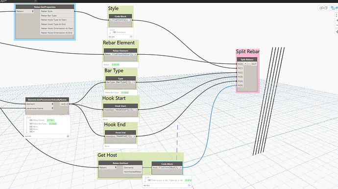

How many curves you’re feeding? Show previews of each node.
Try this Rebar(For ashwin).dyn (22.4 KB)
yes, It works :star_struck:

Hello, I have the same problem with DiRoot node.
I can not create individual rebars from set of rebar according to your Dynamo nodes.
Here is the photo of the structure surface I want to create
