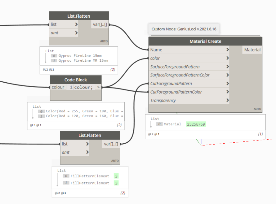

Creating more than 1 material... What am I doing wrong?
How come it’s only creating one material, not two?
Hi @Alien,
The lists of inputs have unequal length (null and lists of data) so use the longest lacing on the Material Create node.
Ah thanks, why didn’t that ocour to me!
I knew that was the problem… but did it in python like an idiot.
Your solution makes way more sense :smiley:
