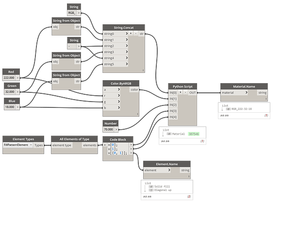

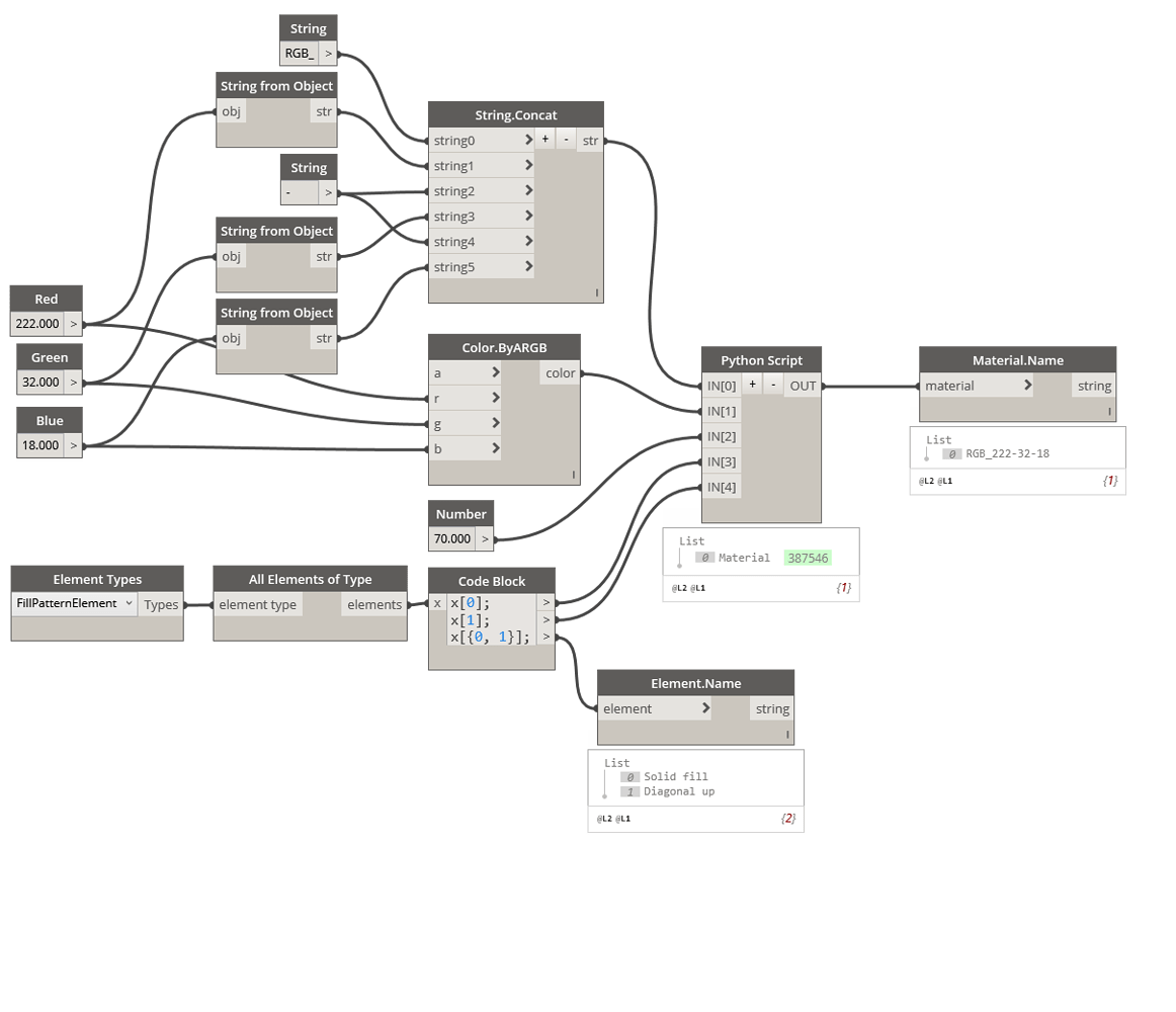

Assuming you mean the python node shown in this image:
https://forum.dynamobim.com/uploads/short-url/dJSC0iWls3y5axqiFjWcvrUNNGQ.pngMy recommended solution for a Python beginner would be to make a custom node out of the Python node, so you can use Dynamo’s built in list levels and lacing to deal with the replication.

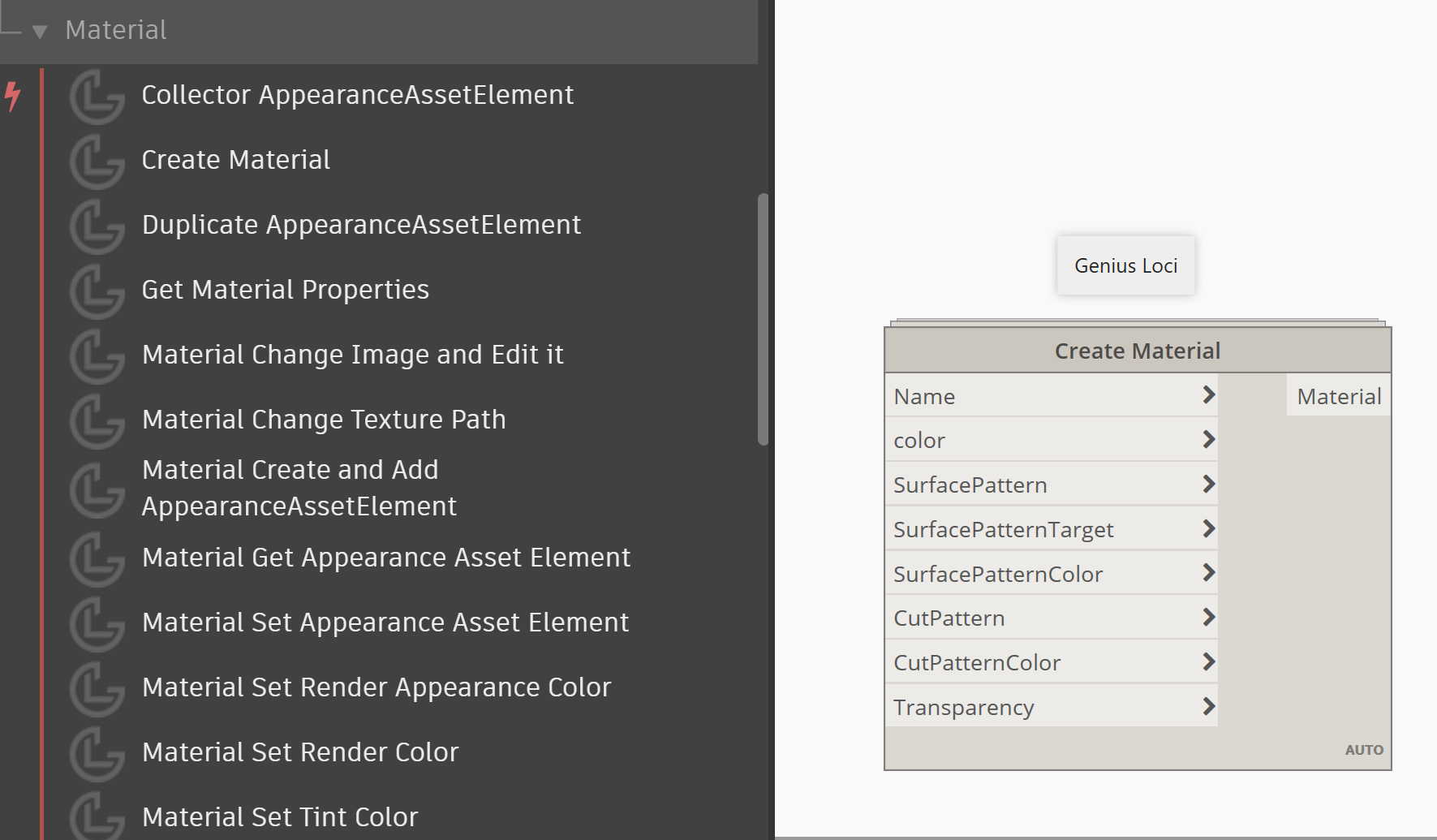

Or you can use a custom node of an existing package.
Some other custom nodes might be useful to you.

i got this from that Genius Loci set…i think this is where i was getting tripped up. i kept getting expected input string getting list
Yes with this part :
#Iterate through the input names list
for n, cl, sp, tar, spC, cp, cpC, trans in zip(names,colors,surfPat,fillPatTargets,surfPatCl,cutPat,cutPatCl,transparency):
i was getting close…but as they say “horseshoes and hand grenades”
