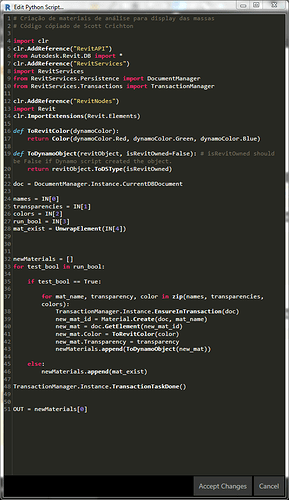

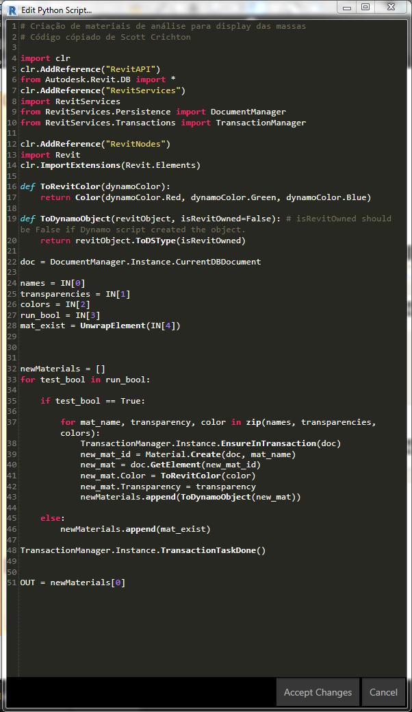

Material Creation/Override with Python
I’ve been trying to develop a code to create a material with specified color, based on the one shown here.
What I need is to create the material but, if it already exists, use the existing one (or override its color, ideally). I’ve created a Dynamo / Python routine for it, verifying the existence of the material with Dynamo and creating the material (or bypassing the existing ones) with Python. I must say that this is my first attempt at using Python or API related methods, so probably I’m missing something.
In Dynamo:
In Python:
# Código cópiado de Scott Crichton
clr.AddReference("RevitAPI")
import RevitServices
import Revit
def ToRevitColor(dynamoColor):
	return Color(dynamoColor.Red, dynamoColor.Green, dynamoColor.Blue)
def ToDynamoObject(revitObject, isRevitOwned=False): # isRevitOwned should be False if Dynamo script created the object.
	return revitObject.ToDSType(isRevitOwned)
names = IN[0]
transparencies = IN[1]
colors = IN[2]
run_bool = IN[3]
mat_exist = UnwrapElement(IN[4])
newMaterials = []
for test_bool in run_bool:
	if test_bool == True:
		for mat_name, transparency, color in zip(names, transparencies, colors):
			new_mat_id = Material.Create(doc, mat_name)
			new_mat = doc.GetElement(new_mat_id)
			new_mat.Color = ToRevitColor(color)
			new_mat.Transparency = transparency
			newMaterials.append(ToDynamoObject(new_mat))
	else:
		newMaterials.append(mat_exist)
OUT = newMaterials[0]
My problems are:
  • The first run returns an error in the Python node, saying Exception: The given value for name is already in use as a material element name.Parameter name: name
  • Despite the error message, the materials are created propperly, what makes me think somehow the Python scripts runs and reruns itself afterwards, finding the materials in the document, causing the error.
  • The second time I hit run, the script runs without errors. The Python script returns the bypassed materials, read by the Dynamo nodes.
What am I missing? I think that maybe finding the existing materials (or their absence) directly in Python would make much more sense, but I couldn’t figure it out.

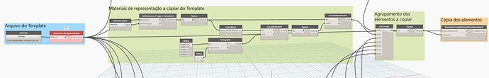

Hi, Shane, I’ve dropped this approach and went for a easier method. Instead of creating /checking the material every time the script ran, I copied the materials that existed in a template file I had set up previously (see the image bellow)
Note: I don’t remember the exact package the Document.BackgroundOpen node belongs to, but I believe it is easy to find out.
Also, if you post your code I can try to help you further. Perhaps a Try / Except could get rid of the error, but I’m not sure.

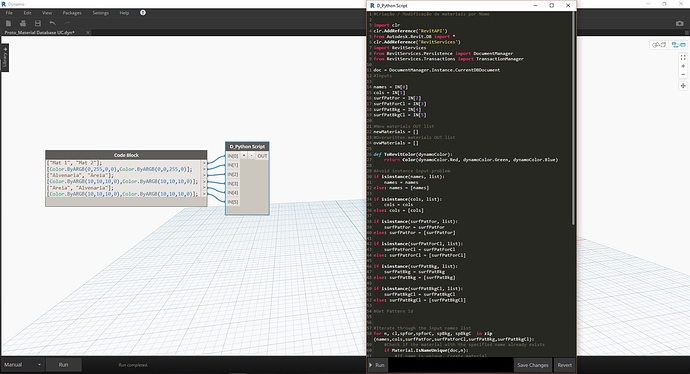

Shane, I believe this script will help you achieve what you want:
#Create or Update Materials based on List inputs
clr.AddReference('RevitAPI')
#Inputs
names = IN[0]
cols = IN[1]
costs = IN[2]
#New materials OUT list
newMaterials = []
#Overwritten materials OUT list
ovwMaterials = []
#Avoid instance input problem
if isinstance(names, list):
	names = names
else: names = [names]
if isinstance(cols, list):
	cols = cols
else: cols = [cols]
if isinstance(costs, list):
	costs = costs
else: costs = [costs]
#Iterate through the input names list
for n, cl, cs in zip(names,cols,costs):
	#Check if the material with the specified name already exists
	if Material.IsNameUnique(doc,n):
		#If name is unique, create material
		new_mat_id = Material.Create(doc, n)
		new_mat.Color = ToRevitColor(cl)
		new_mat_Cost = new_mat.get_Parameter(BuiltInParameter.ALL_MODEL_COST).Set(cs)
		newMaterials.append(n)
	else:
		#If it already exists, collect it and modify it
		namePar = ParameterValueProvider(ElementId(BuiltInParameter.MATERIAL_NAME))
		fRule = FilterStringRule(namePar,FilterStringEquals(),n, True)
		filter = ElementParameterFilter(fRule)
		exist_mat = FilteredElementCollector(doc).OfClass(Material).WherePasses(filter).ToElements()
		#Iteration is necessary because the output of exist_mat is invariably a list
		for em in exist_mat:
			#Modify the Material Properties and Parameters
			em.Color = ToRevitColor(cl)
			emCost = em.get_Parameter(BuiltInParameter.ALL_MODEL_COST).Set(cs)
			ovwMaterials.append(n)
OUT = newMaterials, ovwMaterials
It actually does what I initially intended to do, and a bit more. It checks if the material already exists in the document and, if not, creates a new one (with the properties and parameters as desired). If the material already exists, it overrides the properties and/or parameters of the element (Material). The problem I faced in my first attempt was that the methods to create and to modify a Material are different, so it is fundamental to find out if the element already exists or not at foremost. Since I don’t know which parameters and/or properties you intend to control, I left an example of each kind of operation. Also, the output of the node is set up to display which materials were created and which were overwritten. From this point it is easy to connect the materials with an outside source.

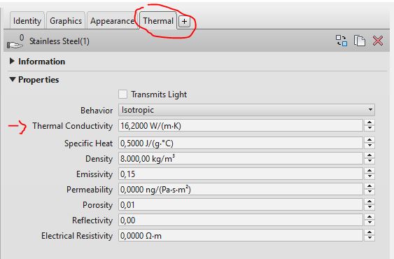

I am hoping to expand this to include thermal and physical properties ( we do a lot of building physics analysis ), I’ll let you know how I get on !
So…
I was able to expand the script to include all of the data on the Identity Data page except for the Material Class has anyone any idea where in the Revit API this value is located? it is the only parameter left on this page that I can’t find.
i have also started looking at adding the thermal data. But have hit a stumbling block, see screenshot below, it is returning “AttributeError: ‘NoneType’ object has no attribute ‘Set’”

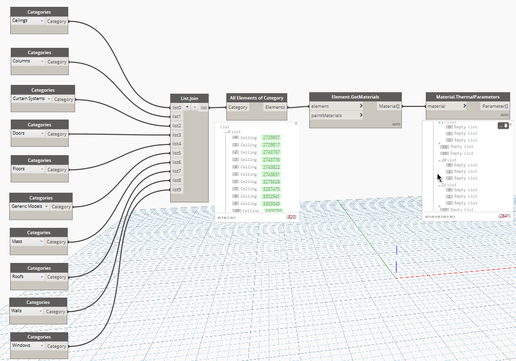

Shane, as it can be seen here the Material’s Class is a property of it, such as Color, not a Parameter. Try to set it with something like new_mat.MaterialClass(string) and check if it works. About the Thermal Conductivity parameter, I believe your problem lies in the nature of the Thermal Property. It does not belong to the API Material Class, but to the ThermalAsset Class, which is associated to the material object (similar to the Appearance asset).
Capturar
So, to achieve your goal, you must either create a new thermal asset to be associated with the material or associate an existing one and then modify its properties. You can refer to the ThermalAsset Class at the API Docs and this thread here that demonstrates the creation of a ThermalAsset with the API. After creating or selecting the Thermal Asset to be used, I think you’ll be able to associate it with the material via the ThermalAssetId Property of the material.
I am not completely sure this is all correct, given I haven’t done it, but I hope it helps you.

if isinstance(surfPatBkgCl, list):
	surfPatBkgCl = surfPatBkgCl
else: surfPatBkgCl = [surfPatBkgCl]
#Get Pattern Id
for n, cl,spfor,spforC, spBkg, spBkgC  in zip(names,cols,surfPatFor,surfPatForCl,surfPatBkg,surfPatBkgCl):
		new_mat.Color = ColorFromString(cl)
		new_mat.SurfaceForegroundPatternId = FillPatternElement.GetFillPatternElementByName(doc, FillPatternTarget.Drafting,spfor).Id
		new_mat.SurfaceForegroundPatternColor = ColorFromString(spforC)
		new_mat.SurfaceBackgroundPatternId = FillPatternElement.GetFillPatternElementByName(doc, FillPatternTarget.Drafting,spBkg).Id
		new_mat.SurfaceBackgroundPatternColor = ColorFromString(spBkgC)
	else:
			em.Color = ColorFromString(cl)
			em.SurfaceForegroundPatternId = FillPatternElement.GetFillPatternElementByName(doc, FillPatternTarget.Drafting,spfor).Id
			em.SurfaceForegroundPatternColor = ColorFromString(spforC)
			em.SurfaceBackgroundPatternId = FillPatternElement.GetFillPatternElementByName(doc, FillPatternTarget.Drafting,spBkg).Id
			em.SurfaceBackgroundPatternColor = ColorFromString(spBkgC)
