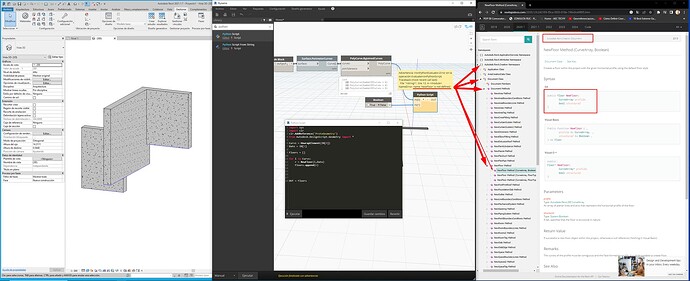

I am continuing my learning of programming with python and now I am trying to create basic floors with python and now I am presented with the following error…
I don’t understand much about the revit api. It would be great if you could teach me how to understand it to apply it in my learning.
How can I correct it… please remember that a simple code will help me understand the solution… thank you very much

Thanks for the comments… in order not to feel confused, it is important for me to be clear about what happens in the code… excuse me if I am very basic but I would like to understand well to properly read a code when making my own.
In the image I describe my query… thank you
Look at the annotated version of the boilerplate code in the link which was previously posted. That explains what the CLR and the main imports are for, which covers #1 and 2 above.
For questio. 3, Document in this case is a class in the Revit.Creation namespace. The * is indicating to bring in all the classes in Creation, which is a lot, but Revit.DB is a LOT more. Reducing the number of imports is a best practice when trying to build effective code as it reduces the amount of items in the memory.
According to what is mentioned in the link and the descriptions of the lines of code, the line of code “clr.AddReference(“RevitAPI”), refers to the dll files of the REVIT API.”, my question would be where are these “DLL” files? " so I can know their names and be able to place or reference them in my Python code
