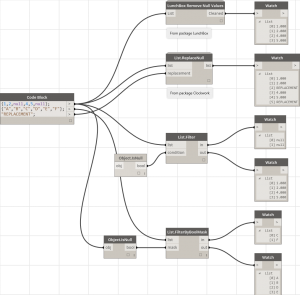

The technique to use depends entirely on the desired outcome:
Ah, those answers both make sense.

Interestingly none of your examples worked Andreas, so my assumption is that Peters observation would be correct?
As shown below: Null not taken out.

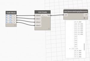

published List.GenerateEmptyElements
Brilliant Peter, many thanks. I’ll have a play with that.
… and I’m such a muppet I can’t figure out where to put it
I assumed after my List.Combine and before my Surface.Area (To match sublist length), but not. Nor into my List.Join or after it. Using it as the ‘comb’ input into a List.Combine node with my Room Names at List1 and my Areas at List2 also fails. Yesterday was a long day and I fear my brain isn’t functioning at optimum right now…

you’ll have to generate both the surfaces and the areas as equally long lists.
why are you wireing the surfaces to the areas?
i would go like that:
creae your list of surfaces
create the list of areas
generate the empty elements for surfaces
generate the empty list for areas
