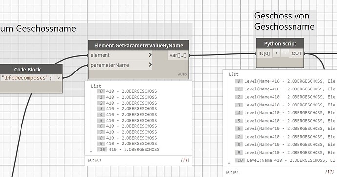

Hi guys I am trying to make the script work but I cannot figure out why it doesn’t work to me. I’ve accomplished the following:
  1. I created a rvt file where I placed few spaces
  2. I exported the rvt file to ifc
  3. I opened a new rvt empty file where I linked the ifc file.
  4. I runned the above script which doesn’t show any error but the finale Python script node is an empty list somehow. The Raum Geschossname node’s code block it has been changed to IfcName as the IfcDecomposes doesn’t exist within the spaces parameter. I understand I should report the parameter which refer to the space name right?
    Same for the IfcSpace which is IfcSpace.INTERNAL instead.
Should I expect to see spaces created within the empty model? many thanks
carmine
Hi carmineaucello,
maybe already the created ifc file is not correct.
Here is another example:
https://www.ifcwiki.org/images/e/e3/AC20-FZK-Haus.ifc
Please try with with this file.
Best regards
Rolf
