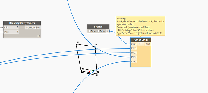

#Copyright(c) 2016 www.Learndynamo.com
#Please contact at jeremy@learndynamo.com
clr.AddReference(‘RevitAPI’)
clr.AddReference(“RevitServices”)
clr.AddReference(“RevitNodes”)
import RevitServices
import Revit
import Autodesk
from math import *
toggle = IN[0]
points = UnwrapElement(IN[1])
modelPoints = UnwrapElement(IN[2])
cropCurves = UnwrapElement(IN[3])
viewType = UnwrapElement(IN[4])
lst =
#Get Family View Type
vft = 0
collector = FilteredElementCollector(doc).OfClass(ViewFamilyType).ToElements()
#eleViews =
for i in collector:
if i.ViewFamily == ViewFamily.Elevation:
vft = i.Id
break
if toggle == True:
for ind, point in enumerate(points):
#Retrieve the mid point of model lines and get X,Y.
modelMP = modelPoints[ind].ToXyz()
modelMPX = modelMP.X
modelMPY = modelMP.Y
#Retrieve individual lines of crop window.
cropLines = cropCurves[ind]
l1 = cropLines[0].ToRevitType()
l2 = cropLines[1].ToRevitType()
l3 = cropLines[2].ToRevitType()
l4 = cropLines[3].ToRevitType()
# Create a line in the z-Axis for elevation marker to rotate around.
elevationPT = point.ToXyz()
elptRotate = XYZ(elevationPT.X, elevationPT.Y, elevationPT.Z+100)
ln = Line.CreateBound(elevationPT, elptRotate)
#Calculate the angle between Model Mid Point and Elevation Point.
elevationPTY = elevationPT.Y
elevationPTX = elevationPT.X
combY = elevationPTY-modelMPY
combX = elevationPTX-modelMPX
ang = atan2(combY, combX)
#Create elevation marker and elevation in position 0.
eleMarker = ElevationMarker.CreateElevationMarker(doc, viewType.Id, elevationPT, 100)
ele = eleMarker.CreateElevation(doc, doc.ActiveView.Id , 0)
ele = eleMarker.CreateElevation(doc, doc.ActiveView.Id , 1)
ele = eleMarker.CreateElevation(doc, doc.ActiveView.Id , 2)
ele = eleMarker.CreateElevation(doc, doc.ActiveView.Id , 3)
lst.append(eleMarker)
crManager = ele.GetCropRegionShapeManager()
#crShape = crManager.GetCropRegionShape()
newCurveLoop = []
newCurveLoop.Add(l1)
newCurveLoop.Add(l2)
newCurveLoop.Add(l3)
newCurveLoop.Add(l4)
cLoop = CurveLoop.Create(newCurveLoop)
try:
crManager.SetCropRegionShape(cLoop)
except:
pass
OUT = lst
else:
OUT = "Set toggle to TRUE"
