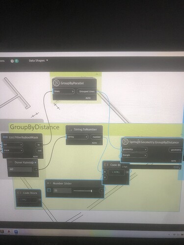

Sorry for asking too much but i to know what i am and how i am doing. What does these inputs meanings?

If the cad lines are not consistently continuous as parallel i script works unexpected way. Like this:
KİRİŞ Açılı.dyn (67.1 KB)
I got another method which can create beams by using uncontinuous parallel
lines but can’t create angled ones.
KirişConsistent.dyn (105.5 KB)
kat1-5 - Kopya.dwg (77.7 KB)
How can i combine these two thing? Creating angled beams from parallel CAD
lines.
