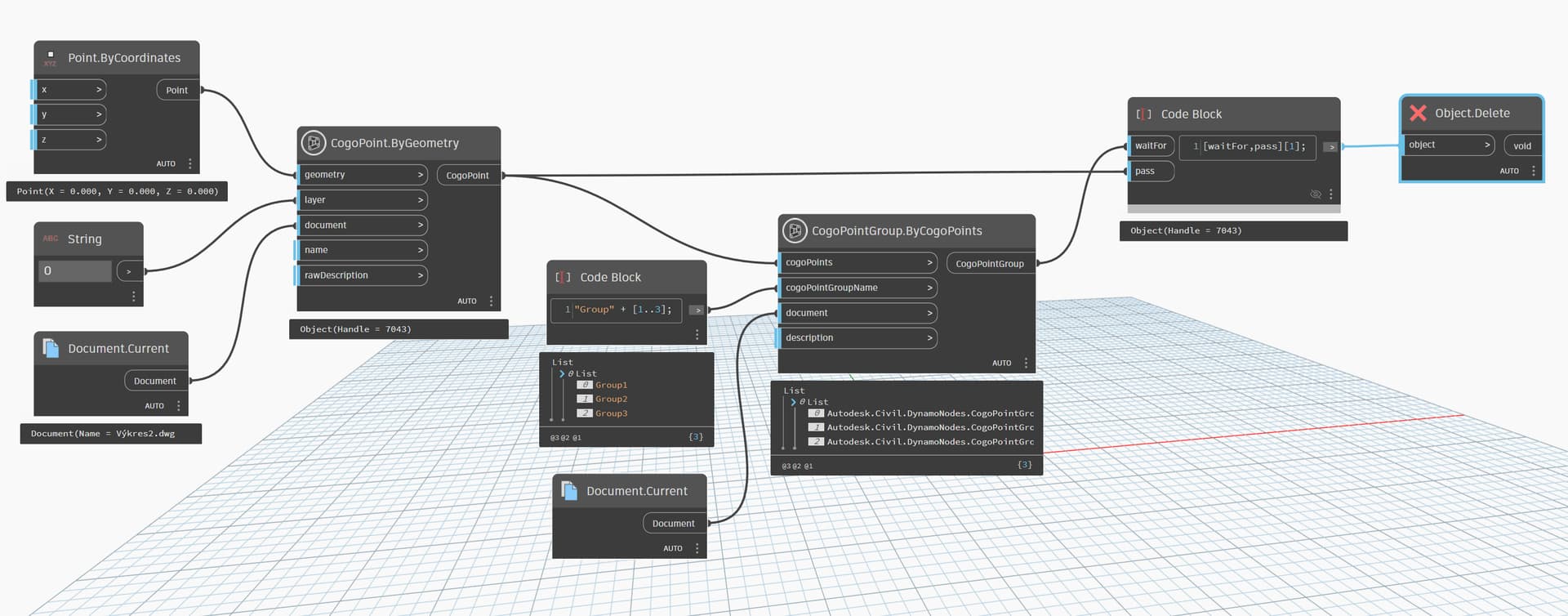

Hi I’m new to Dynamo, I’m trying to create a point group by similar descriptions.
for example I’d like to get all the SPTU in one point group and HDY points in another.
I’ve been bumping my head with this for a day or so any help is welcomed
Rich
Hi @Rich.Cald77,
Does this work for you? From here you would plug the “groups” output into a CogoPointGroup.ByCogoPoints node to actually create the groups.
Thank you worked perfectly
great use of combining string nodes!

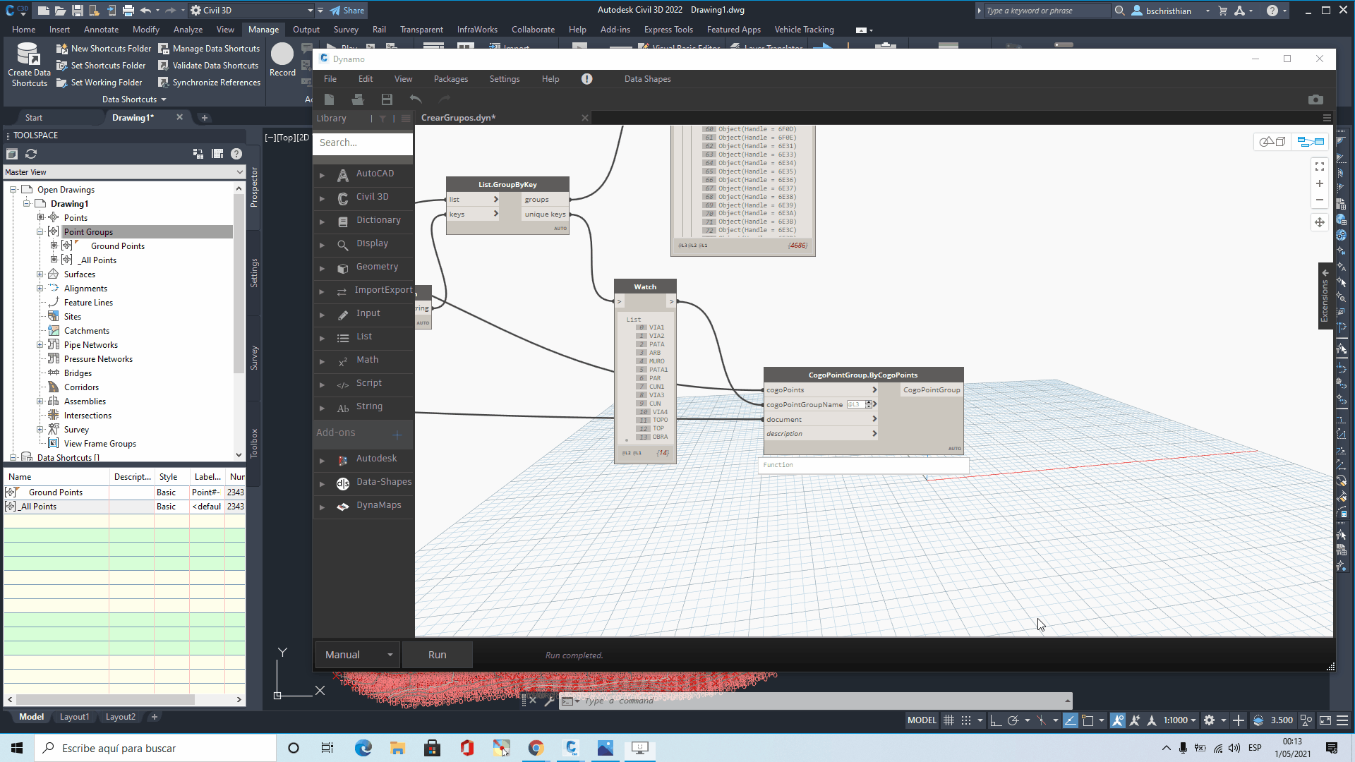

can you tell me how make more group points in same time please ?
Some info about Point group management in the new Dynamo Primer
Point Group Management - Dynamo (dynamobim.org)
thank you but i want make point groups from excel file with diffrent description
POINTS GROUP.dyn (3.2 MB)
Hi, try this workflow, if you want to create more point groups without points.
Maybe this is helping you
