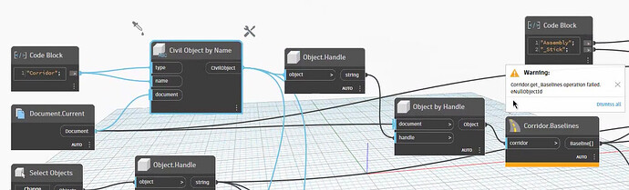

Corridor.Baseline node not working?
Is this a bug?
after we get a corridor by handle, we can’t get the baselines from the corridor.
For this screen shot, we removed a python node whereby we were adding feature line as baseline.
In the process of debugging our python “baseline from feature node” it occurred to us that this isn’t working…
Thanks!
another look at the same error…
Hi @ddrennen2QDK2,
Any chance you could share the DWG?
sent direct via email…thx
Thanks for the dataset. It appears to be an issue related to feature line-based baselines in the corridor, although I can only get it to reproduce on the specific DWG that you sent. In other DWGs with corridors containing feature line baselines, the issue does not reproduce.
We’ll investigate further.
Just to close the loop on this, it ended up being a corrupt corridor model.
My current theory of record is that we corrupted it with our crappy python node for “add feature line baseline to corridor” …which we only need because it doesn’t exist…yet :slightly_smiling_face:
hopefully that is coming in 25.2 also :slightly_smiling_face:
