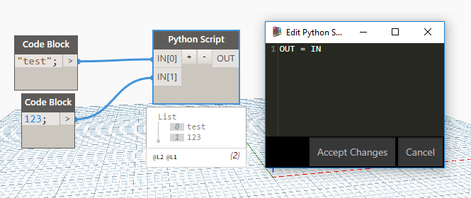

This might (as well) be a stupid question, but why do I have to write.
“angles = IN[0]” and not “angles = IN[ ]”?
If I write OUT= [0] I get the same results but with a “0” as the first value of the output list
Thats because IN[0] is the first port on your python node. IN is a list of all the ports. Maybe this example makes it clearer:
Yes it makes much more sense now. Thanks very much for the help!
