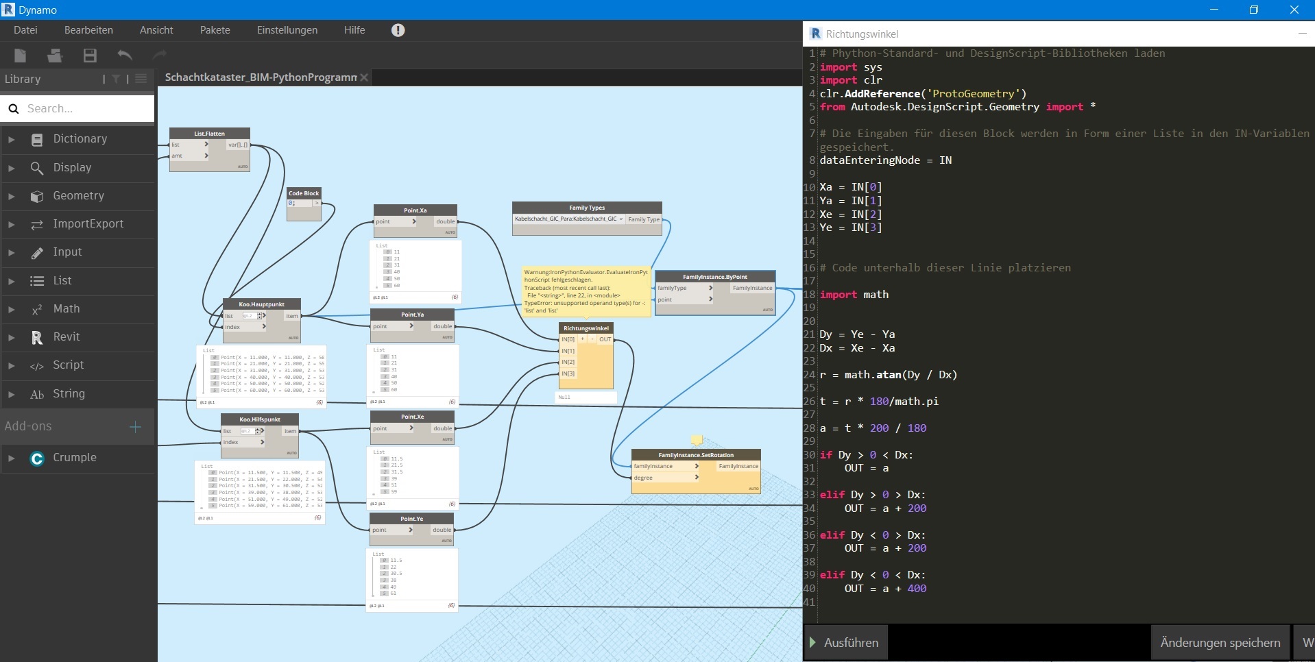

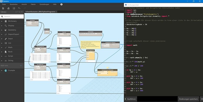

I created a python skript to compute the azimuth between two points in Dynamo. The Script works fine when the Input contains out of two Points. When i change the Input into two lists containing multiple points, i get an error. I attached the part of the Dynamo script as well as the python skript.
Is there someone who can help me with this issue? I would appriciate it a lot.
Thank you in advance and have a great start into the week
Max
Your script is expecting single values but your are inputting lists. Python doesn’t use replication like Dynamo does so I suppose that’s what’s confusing you. You need to iterate over your list inputs, i.e. modfy your Python code so llist inputs can be handled.
