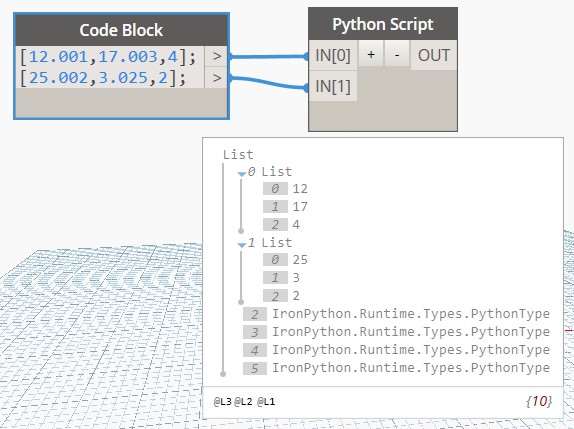

Hello, if the slight digression is possible
the type is not returned?
import sys
a = [round(num,0) for num in IN[0]]
b = [str(int(round(x))) for x in IN[1]]
c=type(a)
d=type(b)
e=type(a[0])
f=type(b[0])
OUT = a,b,c,d,e,f
Capture d’écran 2022-08-19 200831
Cordially
christian.stan
edit:
I’m really stupid, sorry, Mr. Nick had already given the answer above, sorry
Capture d’écran 2022-08-19 202255
