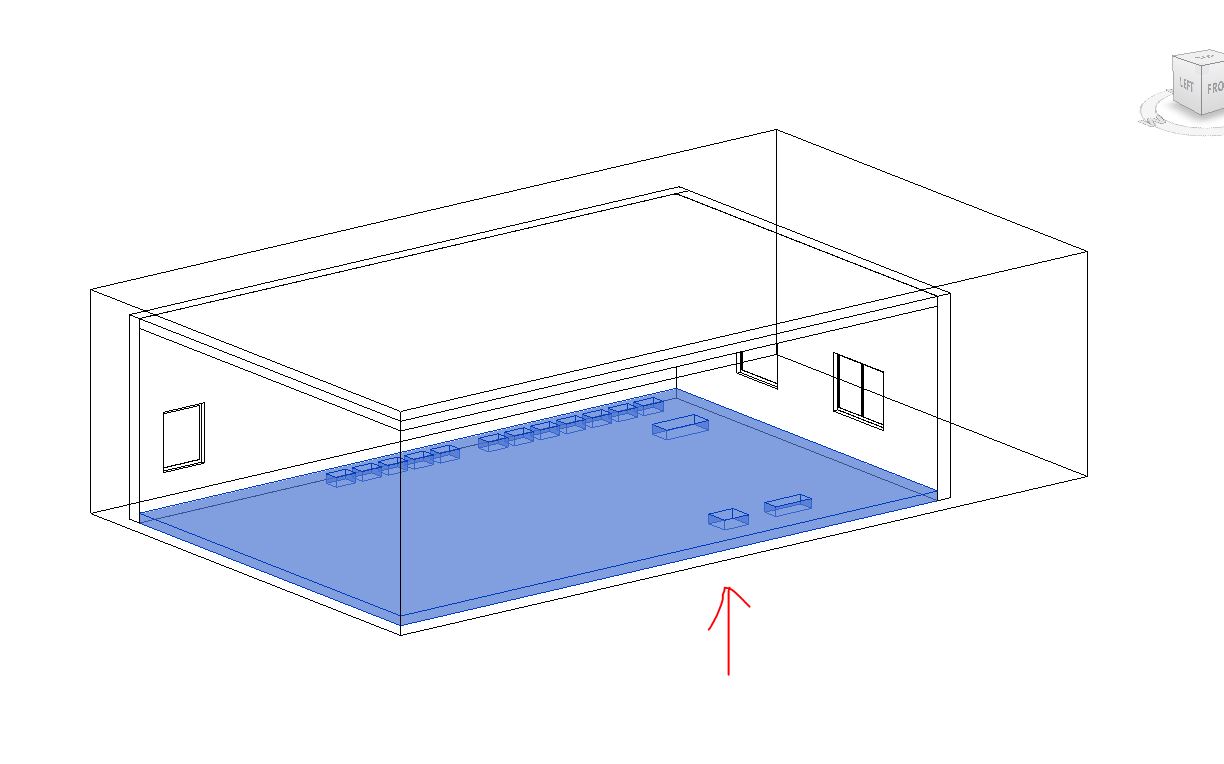

i have a solid geometry that i want to convert it to native revit elements. for example for the floors how can i extract the polycurves of this solid to feed it to the Slabs.Create Node ?

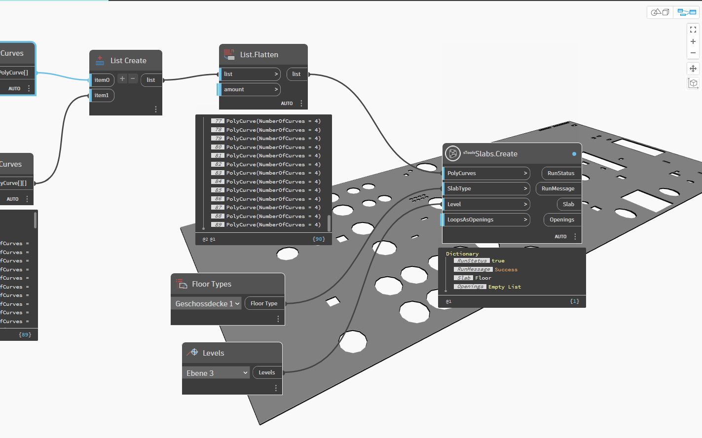

hello, here is a way to recover the limits of your ext and int slab
you will need to install a package and/or generate python code or others
to be able to send several contours (int ext) at the same time to define the outline of the ground
cordially
