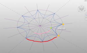

In the image below (Simply created in Revit and a paint hack-job), I would be looking to replicate this using Dynamo. I can’t seem to figure out how to divide a circle.
Legend:
- Red = Outer control curve of X points. This needs to be divided.
- Pink = Inner control curve (circle) of X points. This needs to be divided.
- Green = Singular inner control point for spline by points
- Yellow = Double outer control points for spline by points. Note each outer point must control the end-point of 2x splines.
Am I approaching this correctly for a Dynamo workflow? Or am I hung up in Revit thought processes? Should I follow this thought train or try and create points splayed out in a circular format simply through math?
