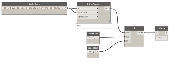

The if statement is ment for a Boolean input on the test. Is the test true, the true is the result. Is the test false, the false is the result.
So you need first to make a comperison to get a boolean output so you can test it.
Better in this case to use a “find and replace” function than a “if”.
