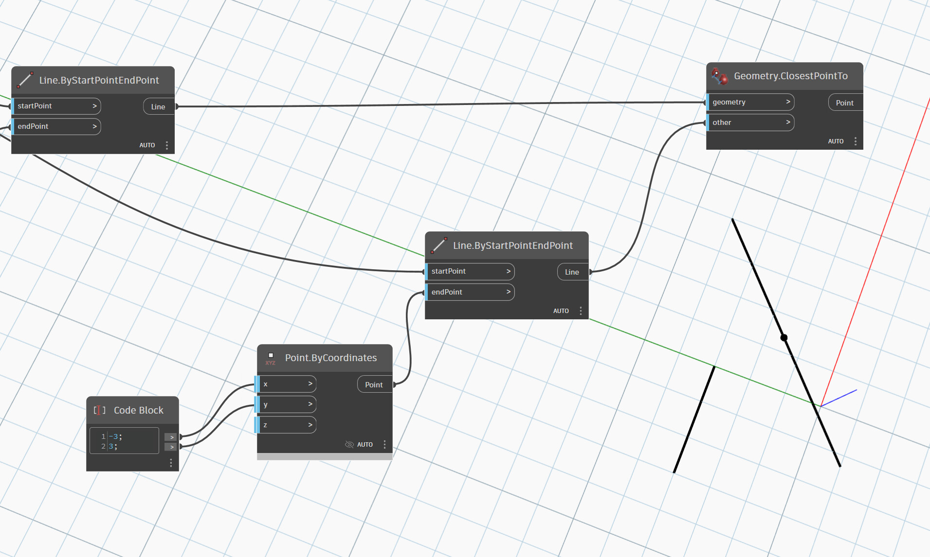

@christopher.riddell ,
thats the concept idea?
KR
Andreas

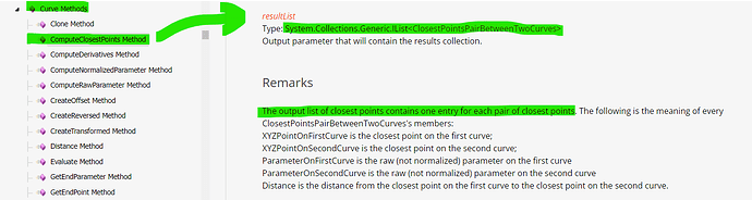

Hello, follow this link you will have the answers to your questions
a try

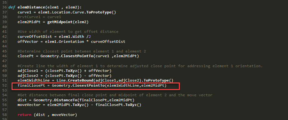

Yeah that was the concept… i ended up pivoting and leveraging those very nodes but in python form so Geomery.ClosestPointTo(Curve1, Pt1) and got closer to my final goal ; however, still stumped as to why the method from the API gave me that error.
thanks for the information , I’ll def check that one out as well.

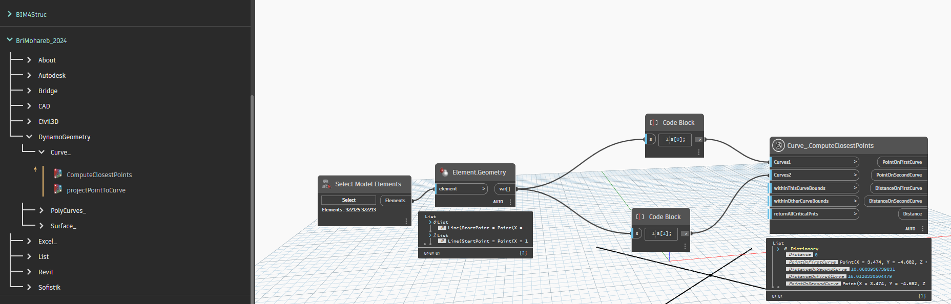

Hi @christopher.riddell
You can use
from BriMohareb_XXXX pak.

Hello, you need an Output list (see api)
you must have these 2 lines of code
import System
from System.Collections.Generic import List,IList
to have an output container
by specifying the type of container.
