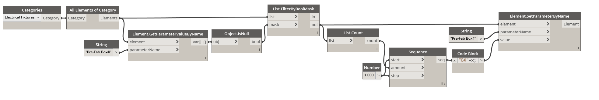

I am trying to combine 2 seperate scripts i have made into a single script. i currently have one script that adds a number value, and another that adds a prefix to that value. I am struggling to make both of these actions happen with one single click of the “Run” button. Please see the attached pics for reference.

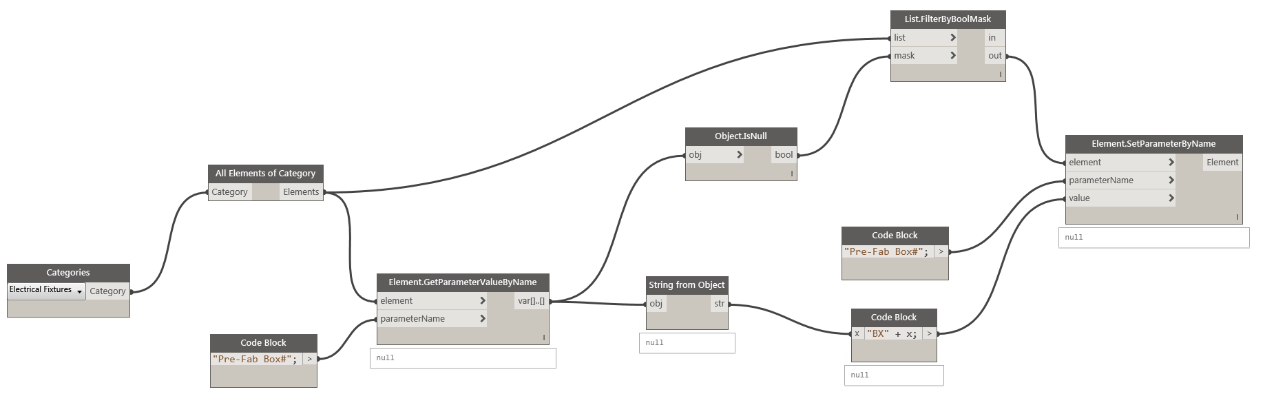

Why not do all this in one run. Below is an example.
Sorry i am new to dynamo. Im having trouble figuring out what you did here.
@bharlow1986 Something like this?
20170412-1.dyn (8.4 KB)
Thanks @Vikram_Subbaiah that worked perfectly
